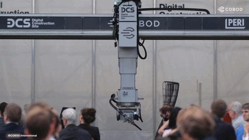

Recently, German 3D printing company COBOD, has announced a joint venture with Technische Universität Braunschweig to produce a commercially available multifunctional construction robot. The robot or gantry follows a computer-generated path and lays down layer after layer of a special type of concrete called shotcrete. Once complete, the robot is removed from the site, and a fully constructed structure remains.

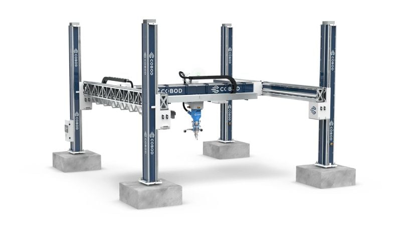

COBOD’s BOD2 3D gantry printer can print and spray concrete
COBOD’s BOD2 3D gantry printer can print and spray concrete. Image used courtesy of COBOD
The BOD2 3D Gantry Printer
COBOD specializes in 3D printing structures for the construction industry. The company recently released a commercially available 3D printer and software that can design, mix, and print objects out of cement. The robotic system consists of a large gantry with a telescoping head and a robot arm attached to the head. The system is marketed as a multifunctional construction robot because the BOD2 is capable of mounting different tools to the vertical telescoping head, such as traditional grippers that can grip bricks or operate sanding tools.
The BOD2 Gantry 3D printer has a printing width of 14.62 m and a
printing height of 8.54 m.
The BOD2 Gantry 3D printer has a printing width of 14.62 m and a printing height of 8.54 m. Image used courtesy of COBOD

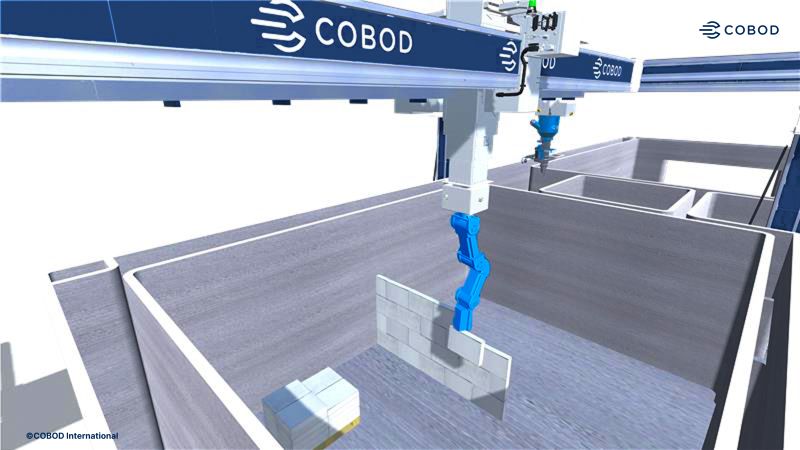

CAD simulation of the BOD2 using a robot gripper to build a wall out
of blocks.
CAD simulation of the BOD2 using a robot gripper to build a wall out of blocks. Image used courtesy of COBOD

If the customer wants a traditional-looking wall, the BOD2 can attach tools such as grippers for moving bricks or building blocks. By making this technology commercially available, COBOD aims to open possibilities to new construction companies and create options for existing ones.
