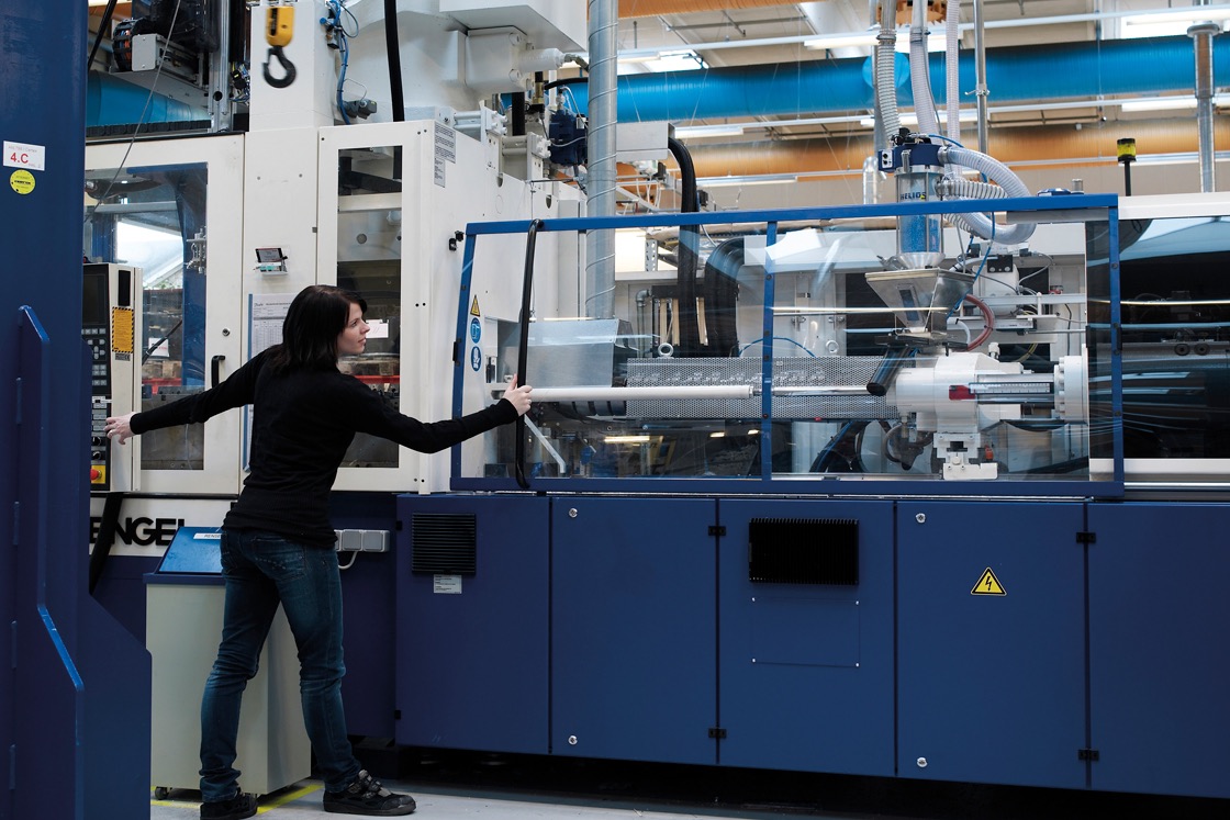

A Danfoss employee operating the company’s plastic manufacturing machinery. Image used courtesy of Danfoss.

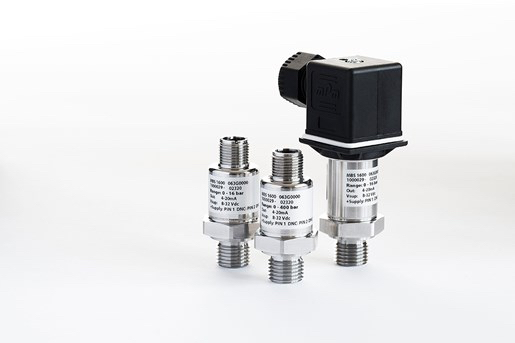

Danfoss MBS1600 pressure transmitter
The MBS 1600 Pressure Transmitter. Image used courtesy of Danfoss.
In terms of specifications, the MBS 1600 comes in two different versions, the MBS 1600 without pulse-snubber, and the MBS 1650 equipped with pulse snubber. Both versions are protected against cavitation and liquid hammering and have a fast time constant of < 1 msec 10 to 90% step response.  They are also vibration and shockproof and can operate between -40 and 125 °.
