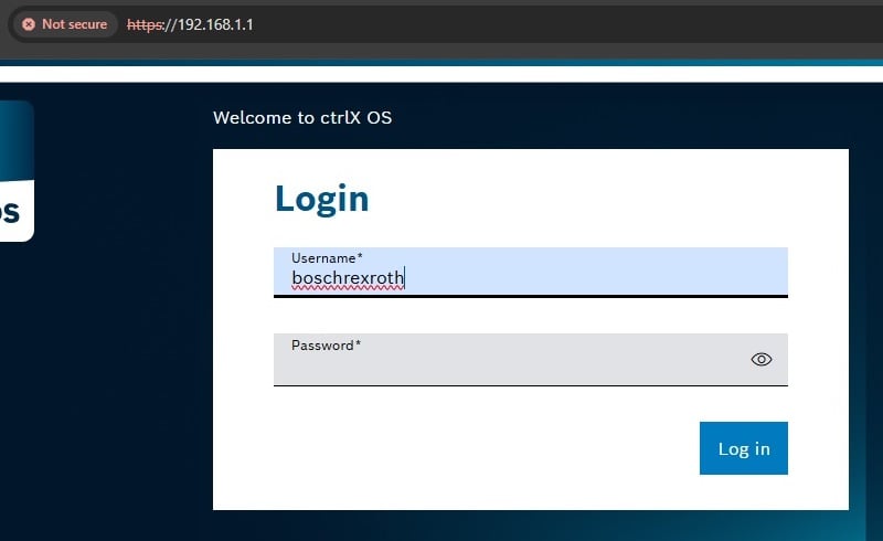

Connect the crtlX to 24 volts, then plug an Ethernet cable between the XF10 port and the port on your PC.
Open a web browser and enter 192.168.1.1 in the navigation bar. The screen will prompt for a login, and the default values are boschrexroth for both the Username and the Password.

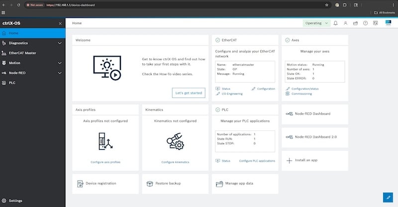

Home
This dashboard provides quick access to all of the other apps, run modes, network nodes, and settings.

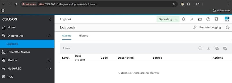

Diagnostics
Normal operational and error messages are displayed in the Diagnostics screen. Even better, each message code is a hyperlink to a help file that describes it in detail.

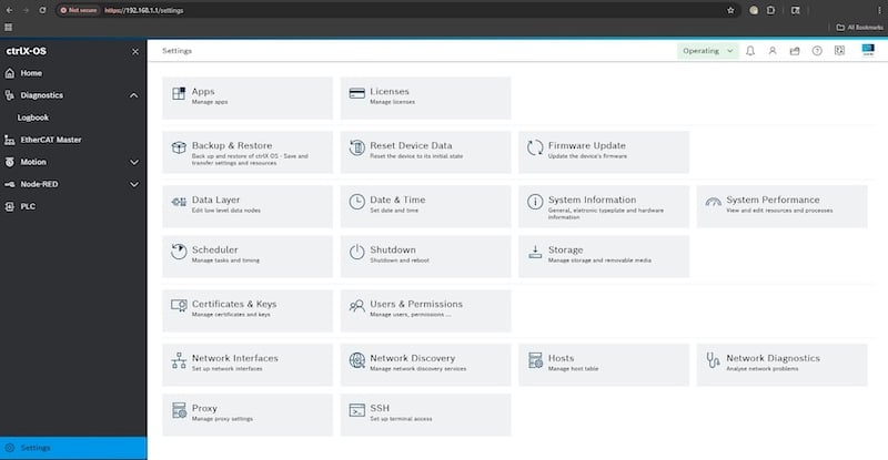

Settings
This menu is the portal to all sorts of user configuration information. From this screen, we can add new apps, add user accounts/groups and change permissions, edit network addresses, access the data layer for various apps, and much more.
