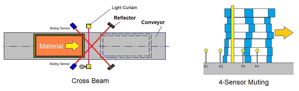

These signals may consist of sets of through-beam sensors aligned in either an X (cross-beam), T, or L configuration. Each signal must come on within a short time of each other, and they must all turn off before the curtain can be muted a second time. There must also be a visual indicator to show when the curtain is in the muted state.
 Figure 3. Cross-beam and 4-sensor muting configuration.
Figure 3. Cross-beam and 4-sensor muting configuration. Image used courtesy of SICK

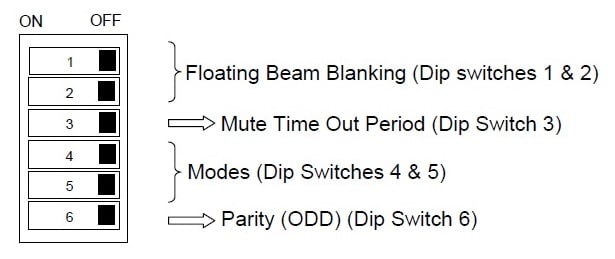

 Figure 5. Example of dip switch settings for enabling and teaching the blanking feature of a light curtain.
Figure 5. Example of dip switch settings for enabling and teaching the blanking feature of a light curtain. Image used courtesy of Smartscan
