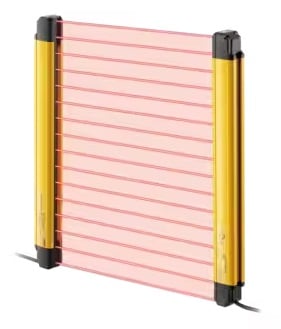

A light curtain is an array of photoelectric sensors, arranged with a sending bar and a receiving bar, used to protect equipment and personnel from physical hazards. These are strictly safety-rated devices that are commonly used in automation equipment. Unlike most other sensors, there are no non-safety versions of light curtains.
When an object blocks too many of the photoelectric beams, a special safety signal turns off, and the machine can be stopped. While this is a very basic description of a light curtain, there is more to them than you might think.

 Figure 1. A standard light curtain.
Figure 1. A standard light curtain. Image used courtesy of Keyence

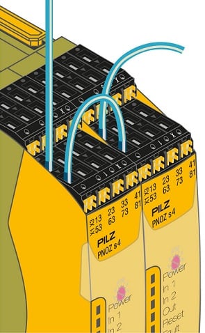

A light curtain can be wired to either a safety relay or a safety PLC.
If using a safety relay, ensure that the relay supports OSSD inputs, as some relays require test pulses through dry contacts. Safety PLCs often contain program blocks that are pre-configured for light curtains, ensuring that both OSSDs energize in the proper sequence. It is up to the programmer to ensure the logic is correct; the system must stop all hazardous motion unless both OSSD signals from the light curtains are properly received.
 Figure 5. Safety relay wiring.
Figure 5. Safety relay wiring. Image used courtesy of Pilz
