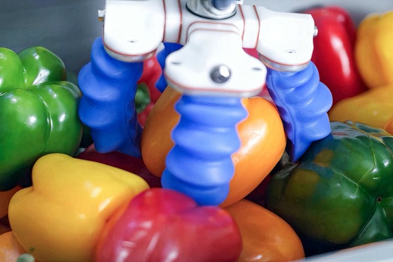

Schmalz’s new mGrip finger gripper is equipped with soft, silicone-based gripper fingers that conform to the shape of each product, ensuring secure yet gentle handling. This innovation minimizes the risk of damage, making it ideal for fragile or irregular items. With its food-grade material composition, the gripper complies with global hygiene standards, eliminating concerns about contamination while ensuring easy cleaning and maintenance.

The mGrip finger gripper features a modular design that offers a significant advantage. Users can use various finger sizes, variable positions, opening angles, and forces. These variation options allow users to tailor the gripper to specific operational needs. Whether the application involves picking soft pastries or arranging bottles in packaging lines, the mGrip’s configurable layout can adapt to various tasks.

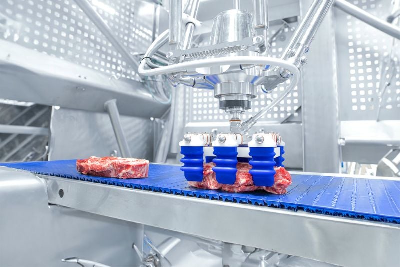

As mentioned, the Schmalz mGrip finger gripper meets the highest hygiene standards, making it ideal for handling sensitive food products. The gripper can be cleaned without disassembly, complying with cleaning in place (CIP) and cleaning out of place (COP) standards. Its non-porous design resists bacterial growth and withstands frequent cleaning cycles, ensuring long-term compliance with hygiene standards. These features make the gripper particularly valuable in food processing and pharmaceutical applications, where maintaining cleanliness is critical to product safety.

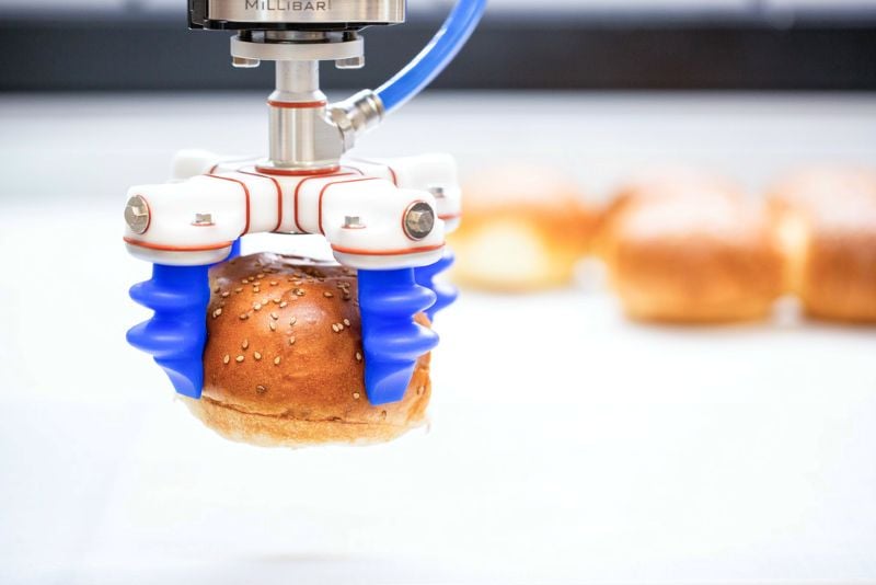

The mGrip finger gripper features a fast picking speed, even with difficult-to-handle items such as bagels and croissants.
The mGrip finger gripper features a fast picking speed, even with difficult-to-handle items such as bagels and croissants. Image used courtesy of Schmalz
