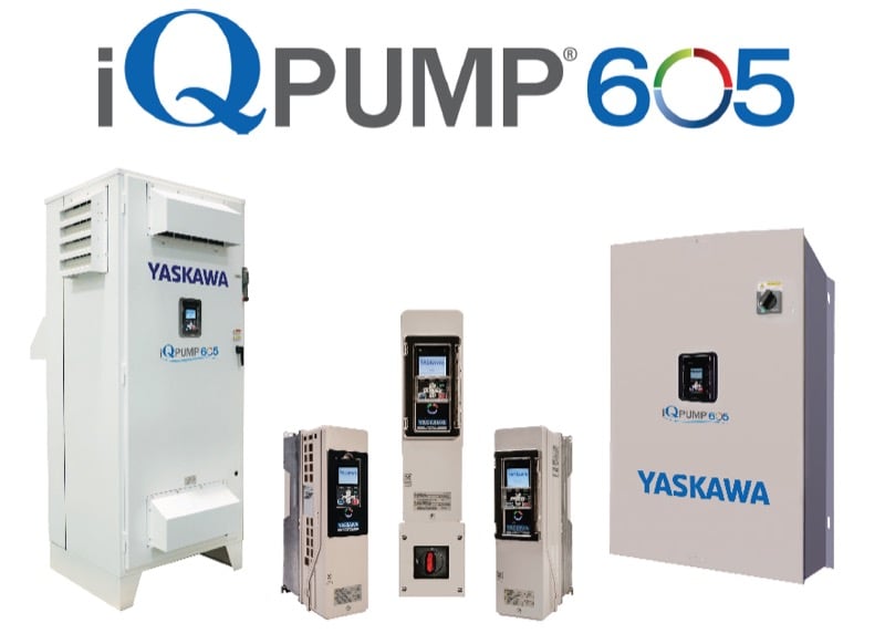

Yaskawa offers the iQpump605 in several enclosure configurations, including IP20, IP55, and UL Type 3R, covering indoor and outdoor use. Depending on the setup, the drive lineup runs anywhere from 3 to 600 horsepower, making it just as useful for a small irrigation pump as it is for a full city water system. The IP55 outdoor versions have been purchased with an integrated disconnect switch for faster maintenance and safety compliance.
The iQpump605 drive lineup offers multiple enclosure options, from compact IP20 units to outdoor-rated UL Type 3R models, to suit nearly any installation.
The iQpump605 drive lineup offers multiple enclosure options, from compact IP20 units to outdoor-rated UL Type 3R models, to suit nearly any installation. Image used courtesy of Yaskawa

The iQpump605 is available in IP20, IP55, and UL Type 3R configurations.
The iQpump605 is available in IP20, IP55, and UL Type 3R configurations. Image used courtesy of Yaskawa
