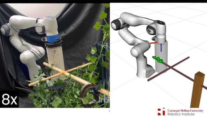

A team of collaborative researchers from Carnegie Mellon University’s Robotics Institute has created an innovative, unique technology that uses contact, instead of conventional microphones (which pick up sound vibrations through air), to sense audio vibrations when interacting with objects.
SonicBoom uses sound to detect and pick fruit by using contact rather than microphones to detect objects. Video used courtesy of CMU’s Robotics Institute
Essentially, the novel SonicBoom hardware features a PVC tube that looks like a boom mic, which has two rings (each fitted with three contact microphones) adhered to the walls of the tube. The microphone-attached rings are fitted at one end of the tube and the other to provide coverage for any contact and subsequent vibrations.
How did the researchers account for distortions in vibrations picked up by the contact sensors resulting from various plastic and metal robotic parts? They employed a learning-based and feature-engineering methodology. The researchers designed SonicBoom to incorporate a learning model trained on three key parameters: GCC-PHAT (generalized cross-correlation with phase transform), Mel spectrograms, and robot proprioception (representing the robot’s sense/understanding of its own movement).
Mel spectrograms help record the energy changes of vibrations across frequencies as time passes, which aids in determining the signal's general shape. However, spectrograms cannot be used in isolation, as they cannot identify which microphone detected the sound initially. GCC-PHAT, a technique that analyses microphone pairs to determine minute pauses between signals, provides that timing information. GCC-PHAT is the primary method for predicting direction since it relies on phase differences rather than volume, making it dependable irrespective of noisy or echo-prone environments.
Robot proprioception—the ability to recognise its own motion—is the third component. The robot is cognizant of its recent trajectory (position and velocity over one second) and is likely to collide with objects in the direction it is moving. SonicBoom learns to identify the location of a sound or disturbance to the robot by combining these three components: proprioception to offer context, GCC-PHAT to quantify when and where the vibration was sensed, and spectrograms to illustrate the vibration.
