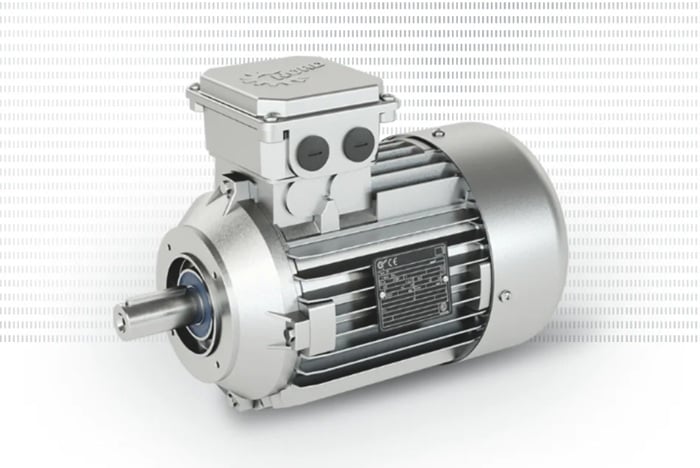

David: I've seen condition monitoring sensors for vibration, temperature, as well as current and voltage to the motor. Is there any key benefit to each of those variables? Or is it always better to simply try to gather as many of these values as possible, where “more is always better?” If not all, which ones are the most critical?
Mark: When I think about this question, I think about the cost trade-off of including these sensor items. If cost were not involved, the answer would naturally be that more is better. Because we don’t typically know ahead of time what will be a critical parameter. We guess at this. Perhaps as we move forward in the IIOT world, this will become a clearer tradeoff.
Temp monitoring is inexpensive. Vibration is somewhat more expensive but perhaps could be if understood and selected properly. Current, voltage, and power all come along for the ride when you use a Nord VFD with the motor.
Lubrication monitoring is, honestly, perhaps the most important, yet it is often given very little consideration. We find that many drive unit failures are simply due to inadequate lubrication maintenance. This can be seen indirectly via temperature or vibration, but sometimes just monitoring the lubrication lifecycle and function would be better.
 Figure 1. A typical 3-phase asynchronous motor.
Figure 1. A typical 3-phase asynchronous motor. Image used courtesy of NORD

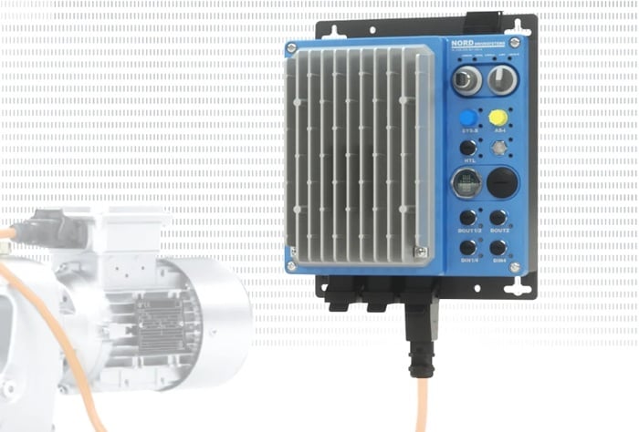

David: What are the various connection scenarios for these sensors? I can think of the following: sensors connected directly to an IPC (IIoT gateway), sensors to VFD which connects to the IPC gateway (MQTT?), and sensors to PLC, which relays the data points via network to the IPC gateway (also MQTT?).
Is this a complete list, and are there pros/cons of each option?
Mark: I think this is a complete list.
The main trade-off with the PLC is its memory and task bandwidth consumption. The PLC is a critical resource that should be handling logic control functions.
Offloading data gathering and analysis to another pathway, like an edge IPC or other IT function, often makes more sense. But there must be an architecture and a logical plan, or the data will be useless. OPC UA and MQTT are communication methods for this.
Sensors are becoming more intelligent and capable. In the coming years, they might be able to communicate directly with the analytic platform using these same methods.
The VFD provides some unique but critical data on the motor or drive system performance. Nord VFDs have a list of useful parameters that are monitored in real time. These can be collected and logged to track drive unit condition. When a high-function VFD is present in a drive system, the ability to read sensors locally and transmit all this data comes with it.
 Figure 2. Motor drives often provide much of the essential data for assessing motor conditions.
Figure 2. Motor drives often provide much of the essential data for assessing motor conditions. Image used courtesy of NORD

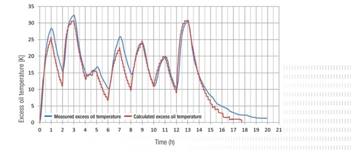

David: What steps are required to package the data and send it to a remote location? When the data values are acquired from sensors or read from a controller, does it require custom programming to convert them into a format that can be transmitted to the predictive maintenance software?
Mark: It does not necessarily require custom programming. There are so many available ways to manage, package, and communicate SQL-based data. For software that requires a custom database arrangement, there would have to be conversion elements either before or after data transmission.
 Figure 3. Comparing projected and measured values can help assess equipment performance.
Figure 3. Comparing projected and measured values can help assess equipment performance. Image used courtesy of NORD
