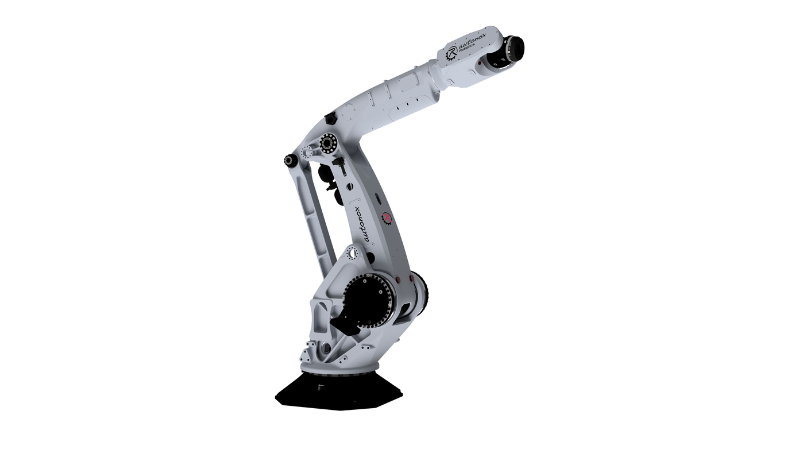

Autonox's latest release is the AT_00018, a six-axis industrial robot with a 280 kg payload capacity that uses serial-kinematics.
The AT_00018 six-axis industrial robot from Autonox
The AT_00018 six-axis industrial robot from Autonox. Image used courtesy of Autonox Robotics
Introducing the AT_00018
Industrial robots are known for having proprietary controllers and motors, which can make integrating vision systems, data collection, and control systems challenging. With the AT_00018 being part of Autonox’s linked robotics program, the end user or machine builder can choose from popular servo motor brands that can be installed by Autonox or the customer.
The AT_00018 consists of three degrees of translational freedom and three degrees of rotational freedom. The robot has a max payload of 280 kg and an overall reach of 3.275 m. The standard model is not hygienic but is IP64 rated and can be mounted on the floor or ceiling. Available motors for the robot are from Beckhoff, Bosch Rexroth, KEB, KEBA, Rockwell Automation, and Siemens.

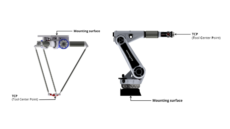

Kinematics is the study of a robot's geometry and how it moves through space. The AT_0018 uses serial kinematics, meaning that all axes, except the first, move together through physical links. Parallel kinematics, in contrast, is where each axis is connected to the base and the end effector, such as a delta robot. The AT_0018's serial design enables greater ranges of motion and higher payloads.
