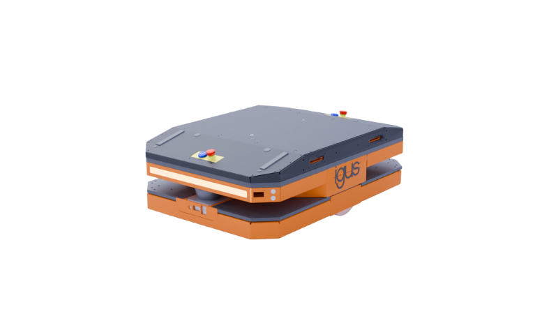

Meet the RebelMove Pro
Measuring 795 mm x 560 mm x 195 mm, the RebelMove Pro is rectangular-shaped AMR driven by a powerful electric drive system. Similar to other AMRs, the RebelMove Pro can lift, carry, and tow shelving and structures to transport products and raw materials. As the RebelMove Pro moves around the floor, its onboard LiDAR creates a 3D map of its environment. This map can then be used in fleet management software to easily program paths.
The RebelMove can travel around at a top speed of 2 m/s and carry up to 250 kg or pull up to 900 kg. These payloads allow the RebelMove Pro to be used in many different applications; it is even possible to mount a robot arm on top of the AMR for use in mobile work stations. The onboard battery is designed to last up to eight hours of operation on a single charge.

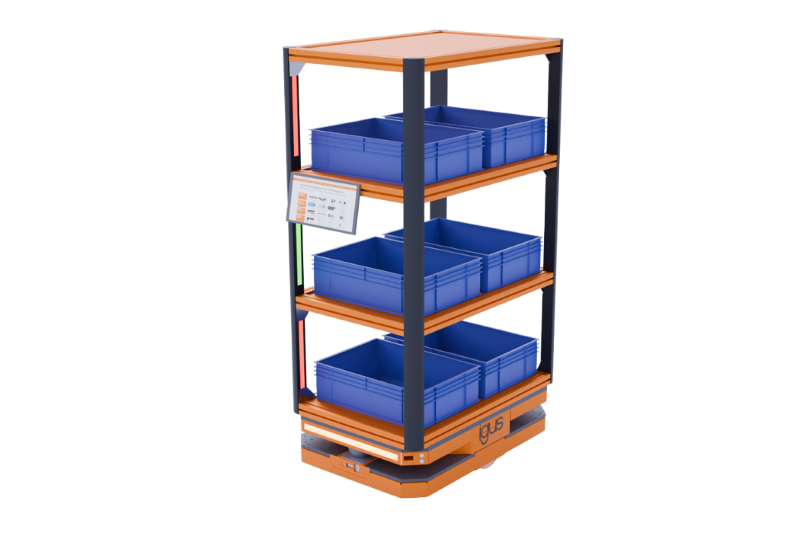

The RebelMove Pro Pick by Light is a mobile shelf unit accessory that enables the RebelMove Pro to transport vertically stacked products
The RebelMove Pro Pick by Light is a mobile shelf unit accessory that enables the RebelMove Pro to transport vertically stacked products. Image used courtesy of Igus
