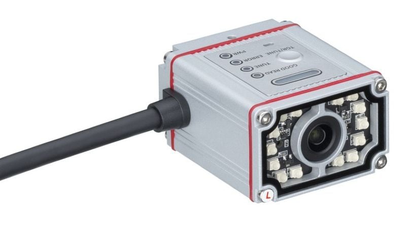

Leuze has introduced its new DCR 100i series code reader to meet modern production demands, combining a high-resolution 1.3-megapixel CMOS imager with an adjustable-focus optical system engineered for flexible working distances. The result is a compact reader that delivers consistent, accurate decoding in environments where small codes, shifting surfaces, and rapid motion typically challenge vision systems.
Leuze’s DCR 100i series features a compact aluminum housing and integrated illumination designed for industrial environments
Leuze’s DCR 100i series features a compact aluminum housing and integrated illumination designed for industrial environments. Image used courtesy of Leuze
DCR 100i Series Code Readers
At the heart of the DCR 100i series code reader is a global-shutter CMOS sensor paired with robust decoding algorithms; an architecture designed to extract clean, accurate reads even when codes are small, worn, or positioned unpredictably. Its 120 frames-per-second capture rate keeps pace with processes running at up to 2 m per second, allowing the device to read bar codes on moving packaging reliably.

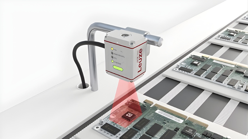

The DCR 100i delivers traceability to the electronics industry with its ability to read small and complex DPM codes on ICs and PCBs
The DCR 100i delivers traceability to the electronics industry with its ability to read small and complex DPM codes on ICs and PCBs. Image used courtesy of Leuze

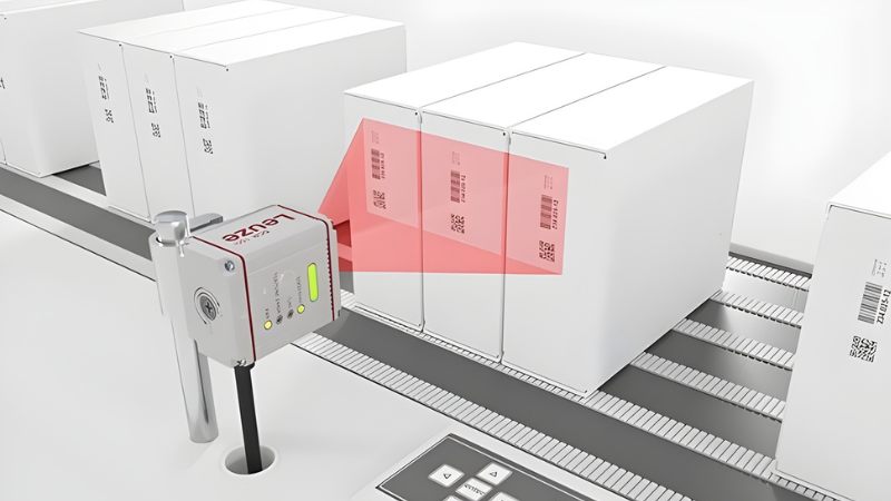

The DCR 100i reads multiple bar codes on moving packaging, demonstrating its wide field of view and high-speed capture capability
The DCR 100i reads multiple bar codes on moving packaging, demonstrating its wide field of view and high-speed capture capability. Image used courtesy of Leuze
In electronics production, the DCR 100i’s DPM reading capabilities and fine-focus modes allow it to read intricate codes on ICs and PCB assemblies with the precision required for traceability workflows. For packaging environments, the device’s fast frame capture and optimized illumination enable accurate reads on boxes moving at conveyor speeds up to 2 m/s. Its ability to decode multiple codes simultaneously offers greater efficiency for grouped packaging lines that require validating both 1D and 2D marks.
