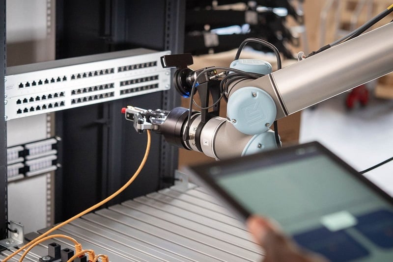

Cable assembly robot
Example application of using MIRAI to pick and assemble RJ45 connections. Images used courtesy of Micropsi
