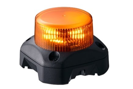

Patlite has released three new rugged signal beacons: the GL7 and GL7T flashing beacons and the GF7 rotating beacon. The new beacons feature a compact IP69 K-rated housing, vibration resistance up to 110 m/s2, and an impact resistance up to 1000 m/s2, making them suitable for use in harsh industrial conditions.
The GL7 (left) and the GL7T flashing beacons emit red, amber, and green light
The GL7 (left) and the GL7T flashing beacons emit red, amber, and green light. Image used courtesy of Patlite
GL7 Flashing Beacon
The compact GL7 flashing beacon offers flexibility when it comes to flash patterns and control options, easily adapting to a wide range of signaling needs. The GL7 can emit red, amber, and green lighting. For control, users can choose from wire lead or CAN communication. CAN communication control supports the SAE J1939 protocol and offers control of up to 13 flash patterns and four brightness levels. With CAN communication control, the beacon offers real-time status monitoring at 250 or 500 kbps for a secure and reliable architecture with no manual setup needed.
