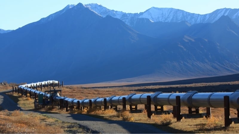

An oil pipeline running through North Dakota.

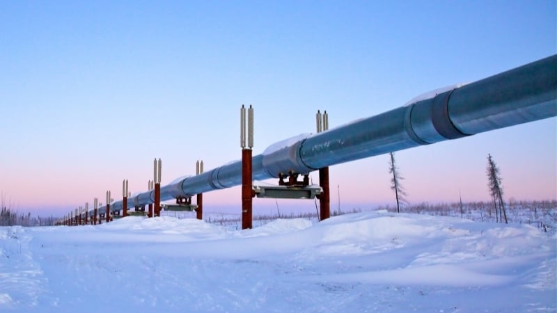

An oil pipeline in North Dakota in the wintertime.

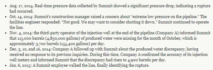

Real-time Pressure Sensors First Detected the Leak
A deeper investigation revealed that the spill was not three million gallons but 29 million gallons, making it the largest spill in North Dakota history. Furthermore, the contaminated water not only affected the two small creeks but reached the Missouri River.
Besides being a larger spill than initially reported, the lawsuits alleged that Summit either knew about the spill or should have known about the spill months before the January 2015 detection. In fact, the official timeline and company documents reveal that the spill had been occurring for 143 days when the leak was finally stopped.
The official timeline shows that real-time pressure sensors first detected the leak on August 17, 2014. The pressure dropped in the line, indicating a leak was possible. A downstream company also reported low pressure on their end and that the number of barrels received was significantly lower than expected. “Not good. We may want to consider shutting down,” stated the facilities engineer. This statement was still months before the rupture was found and the pipeline shut down.
The official timeline from the Department of Justice (DOJ) lawsuit. Image used courtesy of DOJ
The bottom line was that this leak should have and could have been detected earlier, based on the pressure sensor data and the discrepancy at the end of the pipeline. This data was available, with no existing infrastructure upgrades.
Theoretically, if a pipeline is in working order, the flow between one station and another should not change if the line does not branch. If the line branches, the sum of the branches should equal the upstream flow. If there is a difference above some tolerance to account for the time delay in changes and instrumentation error, there may be a leak. To prevent a spill like this in the future, pipeline companies could also deploy flow meters along the length of the line.
