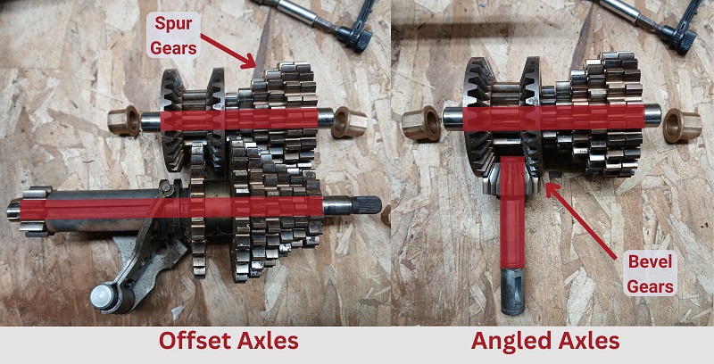

Comparing spur and bevel gears
Figure 1. Spur gears to correct an offset (left side), and bevel gears to correct a 90-degree angle (right side). Image used courtesy of the author
For each type of misalignment, there are common gear choices seen in machines.
Same Angle, But With Offset
If two axles run parallel to each other, but side-by-side, a spur gear would be the most reasonable choice. This kind of gear is the simplest but most common gear type to encounter. The gear itself is a round disk with the teeth cut straight into the face along the outside edge.
No Offset, but With Different Angles
Many times, the motion transmission needs to change directions. If the angle is small, this can easily be accomplished with a universal joint or constant velocity (CV) joint. But if the motion must change 90 degrees, or if it must be transmitted from a single shaft into two output shafts, then the U-joint may not (or cannot) be suited for this task.
A bevel gear set allows this 90-degree alignment by meshing two gears, each with teeth cut into the outer edge of the 45-degree face. This allows the two 45-degree angles together to form a 90-degree angle change.
Bevel gear system
Figure 2. Bevel gears after manufacturing on a gear-cutting machine. Image used courtesy of Adobe Stock
Sometimes, a custom application may use different angles, such as a pair of 22.5-degree gears to form a 45-degree bend, but this is not nearly as common. One of the more recognizable appearances of bevel gears would be inside the differential of a rear-wheel-drive vehicle.

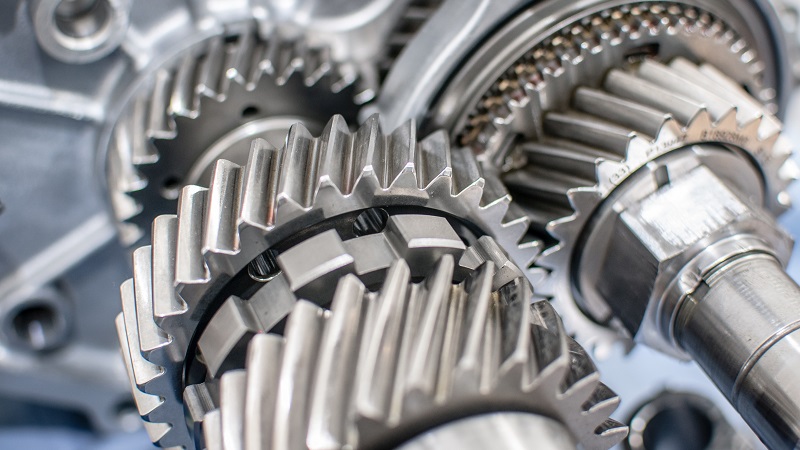

The simpler choice is two gears with much like spur gears, except the teeth are cut at 45 degrees across the outside face, and these are called helical gears. The teeth cut across the front face in either direction, providing the terms ‘left-hand’ and ‘right-hand’. If two like-handed gears are used together, the axes will be 90 degrees apart.
If a left and right-hand gear are used together, the shafts will be parallel, just like a spur gear. With the angled teeth, it can provide less noise and vibration since there is never a gap in the contact area.
Transmission gears with a helix angle cut
Figure 3. These transmission gears have a helix angle cut in order to provide lower noise and more constant force. Image used courtesy of Adobe Stock

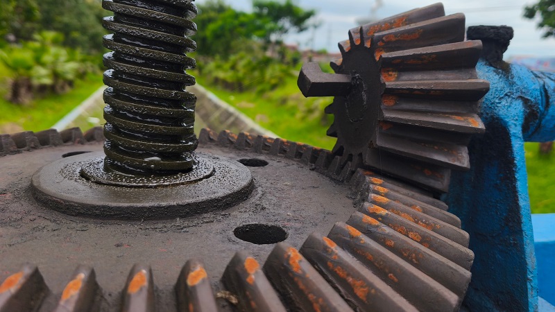

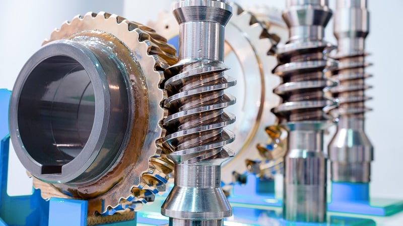

The other type of gear for the offset-plus-angle misalignment scenario of 90-degree alignment is called the ‘worm gear' set.
One gear, the 'worm,' resembles a screw; it's basically one big gear tooth wrapped around a shaft. The worm is always the input shaft. The output is a helix cut gear with a slight angle in the teeth to match the worm gear profile.
The output shaft rotates much more slowly, but with a tremendous amount of rotational force. This is found in all sorts of cases when a high-speed motor is meant to drive a low-speed load device, but with much greater force.
Worm gears in a display
Figure 4. A worm gear set. Image used courtesy of Adobe Stock

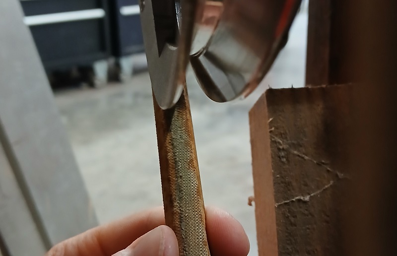

V-belts have a trapezoid cross-section, and they sit inside a pulley with a V-shaped profile. The friction of the belt at high speeds allows motion transfer over a long distance. If one pulley becomes locked up, the motor may still rotate with the belt slipping. This isn't great news for the belt, but it can prevent a catastrophic motor failure.
V belt and pulley
Figure 5. A v-belt being used. Image used courtesy of the author

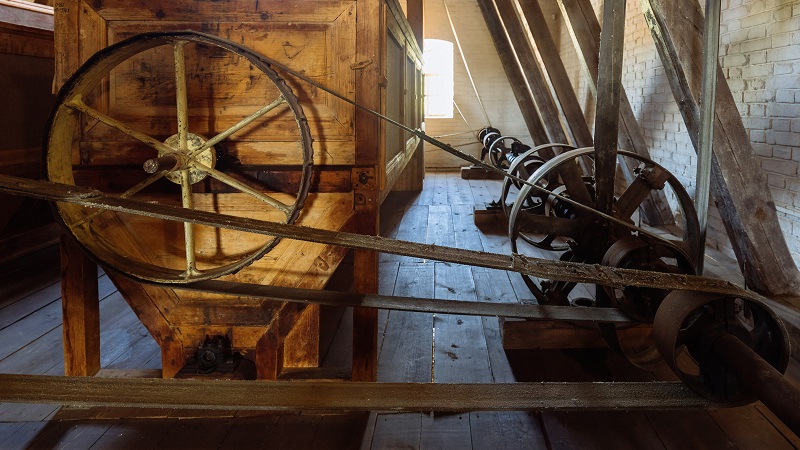

Flat belts run on smooth, flat pulleys. They are often found driving multiple output shafts off of a single main input shaft. It used to be a staple of older steam-driven factories, long before the luxury of a separate motor at each point of motion.
Old factory with belt drives
Figure 6. A restored factory with flat belts driven by a central axle. Image used courtesy of Adobe Stock

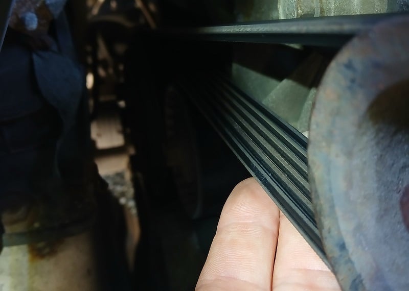

Serpentine belts have ribs running parallel to the length of the belt. The narrow profile makes them very flexible, allowing them to rotate around small pulleys. However, the surface area of the multiple ribs provides much more friction than a flat belt.
Serpentine belt
Figure 7. The flatter profile of a serpentine belt. Image used courtesy of the author

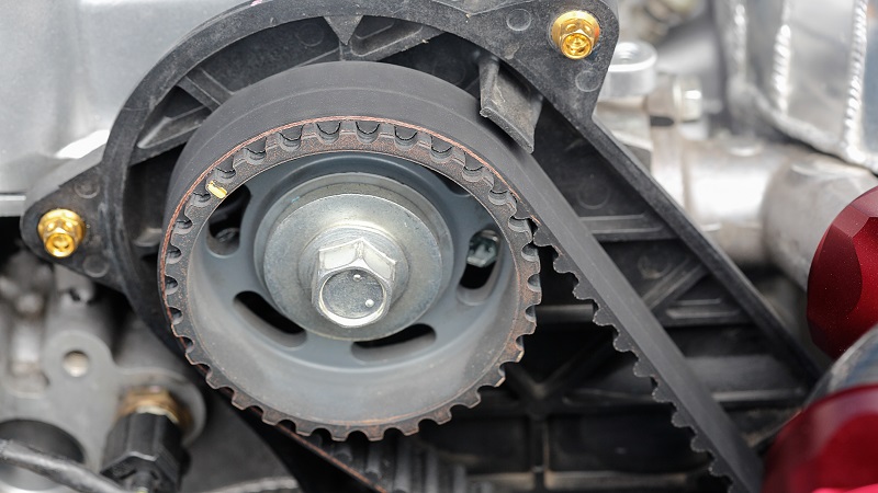

Timing belts are more like gears in the sense that they cannot allow the two pulleys to become disengaged from each other; no slipping is allowed if properly tightened. This is a great choice if two systems must rotate with a very precise relative speed, but they are too far apart to allow a complex gear train between them. Chain drive systems are worth mentioning along with timing belts. Chains can provide a similar precise matching of speed, but are well-suited for low-speed applications.
Timing belt and matching sprocket
Figure 8. A timing belt with a matching sprocket. Image used courtesy of Adobe Stock
