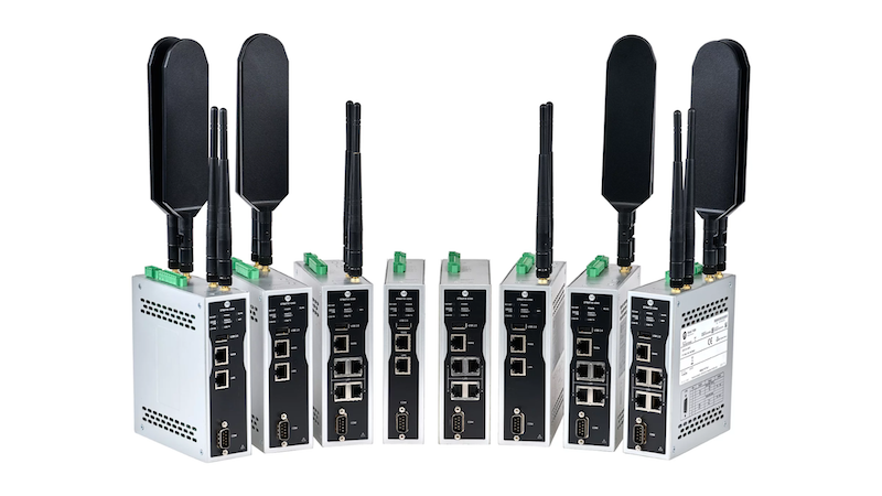

The Stratix 4300 offers users ethernet connectivity through either Cellular LTE or Wi-Fi.
The Stratix 4300 offers users ethernet connectivity through either Cellular LTE or Wi-Fi. Image used courtesy of Rockwell Automation

Rockwell Automation has recently released its latest update to the Stratix 4300, which includes wireless capability. The wireless integration features both cellular LTE and Wi-Fi options, including:
  • Ethernet only (existing product with 2 or 5 ports)
  • Ethernet and Wi-Fi (2 or 5 ports)
  • Ethernet and LTE (2 or 5 ports)
  • Ethernet, Wi-Fi, and LTE (2 or 5 ports)
