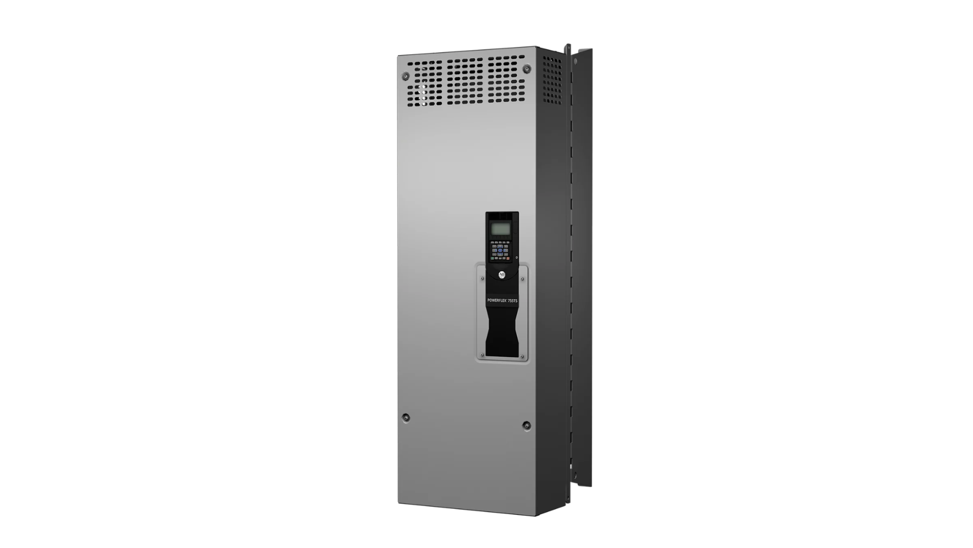

A variety of different PowerFlex 755TS sizes. Image used courtesy of Rockwell
The PowerFlex 755TS lineup consists of many drives capable of driving motors from 1 hp to 500 hp while still having panel mounting functionally. All of the drives within the 755TS series support up to five expansion cards for I/O, communication, or auxiliary power supply. A corrosive gas protection option can be added to any of the 755TS drives which protects the drive when used in environments with corrosive gas.
Recently Rockwell Automation also announced the PowerFlex 755TS family will now support frame 7A sizes which are motors up to 500 hp.
Image of the PowerFlex 755TS Fram 7A. Image used courtesy of Rockwell
PowerFlex 755TS Frame 7A
The new PowerFlex drive from Rockwell Automation is a reduction in overall footprint size but not power. The 755TS low voltage model comes in a panel mount version instead of the typical floor-mounted variety and can drive motors up to 500 hp. Designed for system integrators in the oil and gas and power generation industries the 755TS is said to be easier to maintain and commission.
The 7A model has all of the same features as the other sizes within the 775TS catalog, including CIP safety communications, built-in dual gigabit ethernet ports, compatibility with Studio 5000 programming interface, and TotalFORCE technology.
