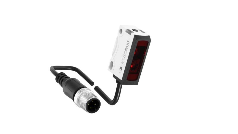

The FT 25-RLAP ToF Sensor
To address common ToF sensing challenges, the FT 25-RLAP sensors feature background noise suppression and window mode. The background noise suppression algorithm removes some of the reflections from objects in the environment, leading to more accurate measurements and fewer false positive strikes. The sensor’s window mode enables users to define an area of importance in the sensor’s view, eliminating even more background noise. It also allows the sensor to be installed in more locations, as unnecessary background items can simply be removed from the sensor’s view.
Outside of those key features, the device has a small footprint, measuring only 34 mm x 20 mm x 12 mm, yet can detect objects as far away as 1.5 m. Each FT 25-RLAP is IO-Link compatible with the 1.1.4 specification, meaning it can be easily integrated with existing industrial automation hardware.
Analog and switching outputs are also available, and operators can switch between modes with the press of a button. The analog output can be programmed with two teach points, and data is linear between those points. Those two teach points can be used to offset and remove some of the background as well.
