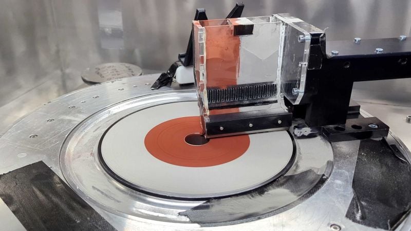

In support of ARIS and under the Focus Project RAPTURE, a group of undergraduate students led by Senior Scientist Michael Tucker and Professor Markus Bambech at ETH Zurich has developed and tested a novel multi-metal, rotating 3D printer in just nine months.

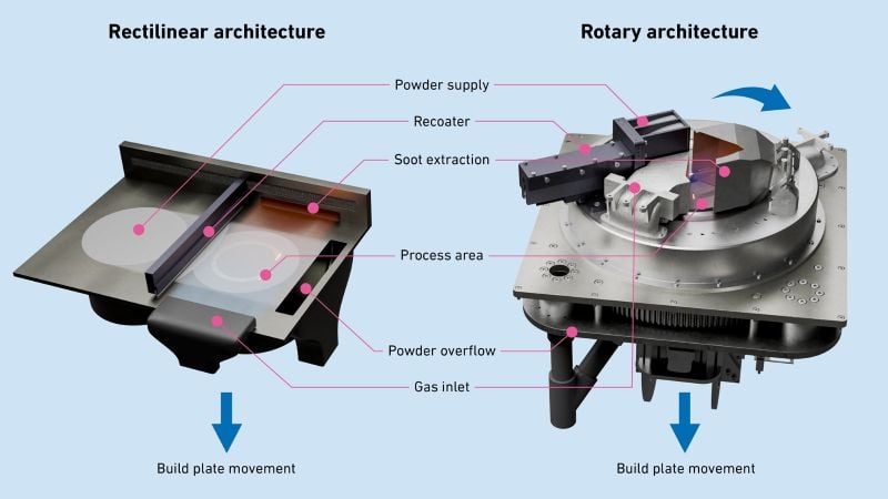

Comparing a conventional 3D printer with ETH Zurich’s RAPTURE device
Comparing a conventional 3D printer with ETH Zurich’s RAPTURE device. Image used courtesy of ETH Zurich
Conventionally, LPBF 3D printing relies on the use of a powerful laser and the selection of an area of powder bed (composed of metal or polymer powder) from which to construct the desired part/component. The laser sinters/melts the powder, and when it fuses, the build platform is lowered to make space for the next layer to form. Powder is supplied through a reservoir or hopper, and a recoater blade spreads a thin layer of powder uniformly across the build platform, ready for laser-guided sintering. Once the part is made, it undergoes post-processing to meet safety and quality requirements.

Students’ newly devised RAPTURE machine differs from conventional LPBF printers in that it employs a unique rotating platform that allows the otherwise sequentially added powder-coated layers to be added and fused by the laser simultaneously. According to ETH Zurich, this is a significant advancement that cuts down the production of cylindrical parts by two-thirds.
The rotating platform of the RAPTURE device allows laser sintering to run continually and not just layer-by-layer as in conventional methods. Video used courtesy of ETH Zurich
Conventional systems typically use larger quantities of metal powder, and mixed powder setups are notoriously difficult to separate without incurring waste. The new RAPTURE 3D printer only deposits the necessary amount of powder for a given part, therefore avoiding unnecessary waste. The novel system also blows inert gas over the powder during laser fusion to prevent part oxidation. By-products of the process are extracted through an outlet.
