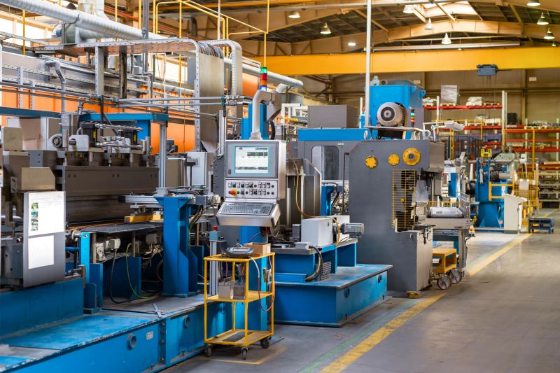

Turck’s IP67 power supplies feature a durable design that enables on machine or wall mounting
Turck’s IP67 power supplies feature a durable design that enables on-machine or wall mounting. Image used courtesy of Adobe Stock

In addition to IO-Link communication, Turck’s new power supplies feature an IP67 rating and a wide temperature range, allowing them to be utilized in harsh environments. This durability enables the next upgrade within Turck’s new design: the ability to mount the power supplies directly on machines or walls. On-machine or wall mounting eliminates the need for a control cabinet, reducing installation time and cost. These features make Turck’s new power supplies a robust and efficient choice for industrial applications, especially where harsh conditions and flexible installation are vital considerations.
