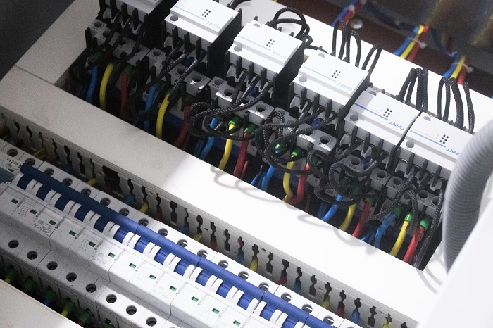

In some situations where you need to control a large load, 24 VDC would draw too much current, so a different control voltage needs to be used. Some large motor contactors use 120 or even 220 VAC for this reason. This voltage is already available in the motor control cabinet, so it makes sense to use it for these larger controls.
Space and Cost Saving
Another reason to use an AC control voltage is when there is simply not enough room in the control cabinet for a power supply. Main power needs to be converted to 24 VDC, and if there is no room physically to fit the power supply, you may need to look into an AC contactor. Also, if there are no control devices that need DC, it might be cheaper to simply omit the power supply and make use of AC relays and solenoids.
