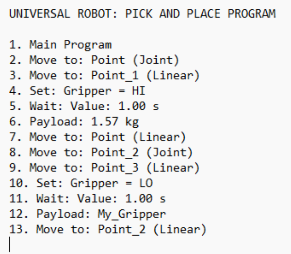

Starting with the UR, let’s break down the pick-and-place code one line at a time.
  • Beginning on line two, the robot makes a joint move to an intermediate position just above the object to be picked. A joint move is appropriate here because we’re moving freely in space with no nearby obstructions.
  • Then, on line three, the robot performs a linear move directly downward toward the part. This ensures a perfectly vertical movement in the Z-direction, which is critical when aligning with the object.

  • Once in position, the robot triggers the end-of-arm tool (EOAT)—in this case, a gripper—to close by sending a signal high (line 4). It waits for one second to ensure a firm grip, then updates its payload to account for the added part weight.
  • After gripping, the robot performs another linear move upward, followed by a joint move across open space to the destination location (lines 7-8).
  • Once there, a final linear move places the part, the gripper releases, and the robot returns upward, ending the routine (lines 9-13).
The standout feature of the UR interface is its simplicity. Every command is nested under a “+” icon, which opens up common tasks such as movement, wait commands, I/O signals, and conditional logic. It's a visual system designed to make programming accessible, even for beginners. Pop-up windows guide the user through input fields, and intuitive icons (like a pencil for editing) make it easy to find and adjust program parameters. Think of it like Apple’s design philosophy: minimal, clean, and straightforward.
