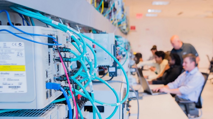

Get Training and Knowledge
By reading this article, you’re already on this step, but don’t stop here by any means. This subject is first on my list for a reason: it is the most important thing. I’m a major Allen Bradley user, so finding an AB Network Fundamentals Course (CCP184-EL) would be highly advantageous for me. You might be using Siemens PLCs or perhaps one of the Automation Direct PLC families. Try to find a training that relates specifically to you and your equipment if possible. You’ll be greatly helped by the hardware familiarity you will receive.
 Figure 1. Training tailored to your specific network can be invaluable.
Figure 1. Training tailored to your specific network can be invaluable. Image used courtesy of Rockwell Automation
There are tons of different trainings out there to choose from, but not all of them will educate you about industrial applications. Finding an automation distributor with a class can be very helpful because they understand how automated facilities work. If you receive guidance and lay out your facility like an IT center with only IT hardware, you may find yourself in a pickle down the road. Try to get your knowledge from people in your field. Don’t lay out a telecom center like a sawmill, and likewise, don’t lay out your sawmill like a telecom center.

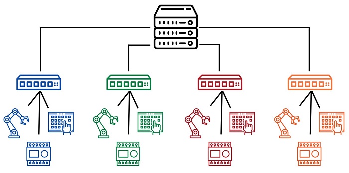

Network Segmentation
Network segmentation refers to how a network can be laid out and isolated from other sections of itself. Think of it like a school. A one-room schoolhouse (single network for everything) works well when you only have 12 students in the school. When you have 400 students, you will quickly find out you need to segment them into different classrooms because everyone will be talking over each other and it would take far too long for everyone to speak up, share ideas, and respond to requests.
Accomplishing this segmentation is going to take time and a variety of perspectives. Here’s an example. I work in sawmills where lumber travels from one processing machine to another. Each machine center has a single master PLC controlling it. Occasionally, there are multiple PLCs in a single machine center, but there is only one master PLC. It makes sense in our sawmills for the networks to be segmented with one portion of the network (a subnet) dedicated to each machine center.
 Figure 2. Network segmentation can include subnets to divide functions, physical regions, or machine centers. Image used courtesy of Control.
Figure 2. Network segmentation can include subnets to divide functions, physical regions, or machine centers. Image used courtesy of Control.com
Another application could be a facility that uses many short assembly lines to make a product from start to finish. It could make sense for this facility to segment its network with a subnet for each line. Take your time and have multiple knowledgeable people work together to ensure the plan will stand the test of time.
