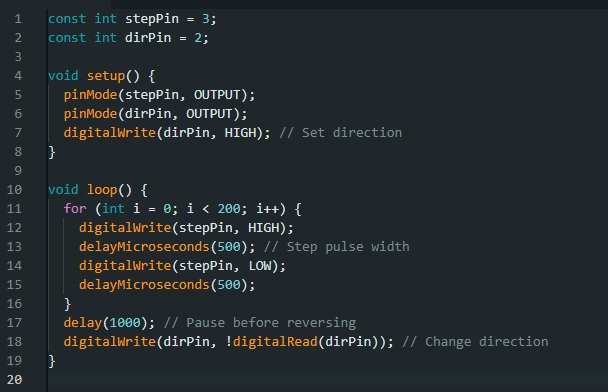

When writing the control logic in Arduino, I explored two different methods and tested their effectiveness. The first approach was directly adding microsecond delays between the “HIGH” and “LOW” states of the “stepPin” connected to the CP- terminal of the stepper motor drive. The downside of using this approach is that in cases where two motors need to run simultaneously, it becomes a challenge as the program is executed sequentially. The delay between subsequent steps for each motor will vary based on the delay for the other motors. This variability isn’t exactly an ideal solution.
 Figure 3. Sample program in the loop function for stepper motor pulse generation with a 500-microsecond step pulse width.
Figure 3. Sample program in the loop function for stepper motor pulse generation with a 500-microsecond step pulse width. Image used courtesy of the author

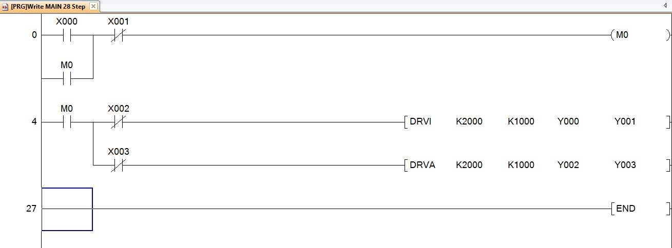

There are several methods of handling stepper motor control in the PLC. A previous stepper motor control project with the Mitsubishi FX Series PLC worked well for this project, as there were high levels of flexibility when it came to speed and direction. For this project, drive relative instruction (DRVI), which allows control by defining the number of pulses and the direction of movement of the motor, was used to implement relative motion logic.
DRVI increments the position of the motor rotation until a condition to stop the instruction is triggered. For instance, limit switches X002 and X003 can be used to stop the motor control instructions in the ladder logic below, ultimately stopping the motion of the stepper motors.
 Figure 5. Sample ladder logic program driving two stepper motor axes: DRVI (drive incremental) and DRVA (drive absolute) instructions with limit switches X002 and X003 to halt motion, one for each axis.
Figure 5. Sample ladder logic program driving two stepper motor axes: DRVI (drive incremental) and DRVA (drive absolute) instructions with limit switches X002 and X003 to halt motion, one for each axis. Image used courtesy of the author
DRVA instruction is used in cases where absolute positioning is needed. To further enhance flexibility in control, data registers are used in conjunction with a human-machine interface (HMI) to handle variable inputs like frequency and the number of pulses. To best manipulate these variables in Mitsubishi PLCs, the MOV instruction is used to transfer constants within a ladder, allowing flexibility in parameter settings. For instance, an HMI can have a number input interface that stores the keyed-in value to a data register such as D3 that can later be used in a control logic as represented below.
