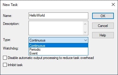

There are three different schedules you can pick from when creating tasks: Continuous, Periodic, and Event.
 Figure 1. Setting the schedule type of a new task.
  • Continuous tasks run all the time, unless the controller is stepping out to handle one of the other tasks. You can only have one Continuous task per controller.
  • Periodic tasks run at a set schedule and are prioritized against each other.
    • You must choose the period or interval between each occurrence of the task. The period is measured in milliseconds (ms).
    • You also need to select the task’s priority. Priorities range from 1 to 15; the lower the number, the higher the priority. If you’re in the middle of a priority 10 and a priority 1 task occurs, the PLC will drop the 10, execute the 1, then pick up the 10 where it left off. If multiple tasks are running with the same priority, the PLC will do a 1 ms round-robin execution of the equivalent tasks.
  • Event tasks are only executed when called for.

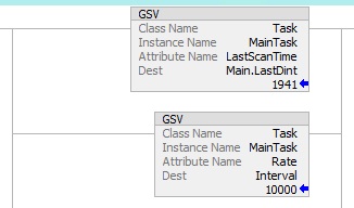

The Continuous task must be changed to a scheduled type, but now our timing is off because we can’t simply look at the last scan time of the task. I set the Scheduled task to 10 ms and placed it as the highest priority. Once this is done, we’d like to monitor the time passed for each scan cycle of the controller, giving us a way to measure any inconsistencies.
If you remember above, the time displayed in that GSV instruction is set to the last scan time of the task itself, not the total time passed in the controller. To remedy this, I need to add the task schedule time into the calculation. Now, knowing I set the timing to 10 ms, I could simply add 10000 microseconds to the last scan time, which would work, but it is just as shortsighted as the original use of the Continuous task. If the interval ever changed, this addition would need to be adjusted.
Instead, I can retrieve the actual schedule interval of the task. This process now uses two GSV instructions and some math. The first instruction, like before, measures the amount of time the task took to complete. The second instruction looks at the task information again, but this time it retrieves the Rate Interval, which is the actual scheduled time. Add these two values and the total time of the task+interval is calculated.
 Figure 3. Retrieval of both the scan time and the interval of the MainTask.
