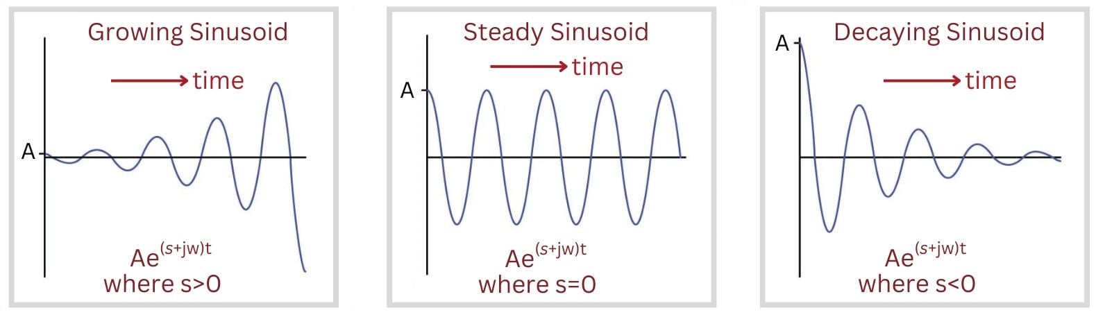

If we set \(\omega\) at some constant value and experiment with different values of \(\sigma\), we can see the effect \(\sigma\) has on the shape of the wave over time:

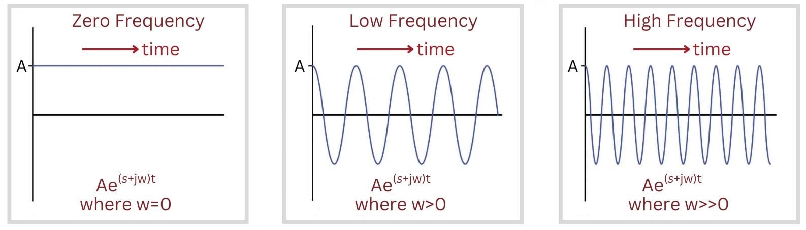

If we set \(\sigma\) at zero and experiment with different values of \(\omega\), we can see the effect \(\omega\) has on the shape of the wave over time:
