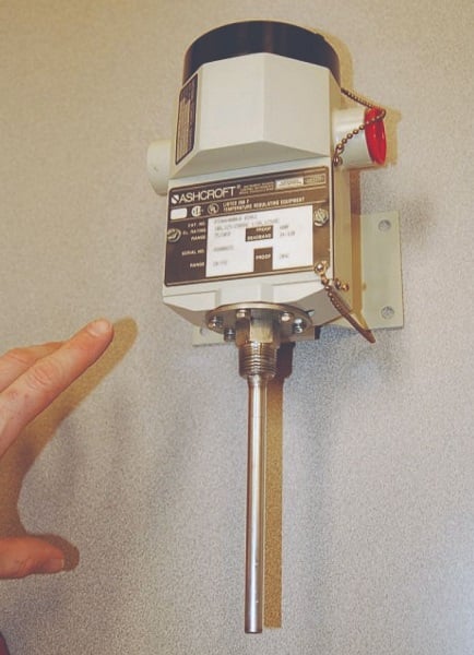

The following photograph shows a temperature-actuated switch manufactured by the Ashcroft corporation:

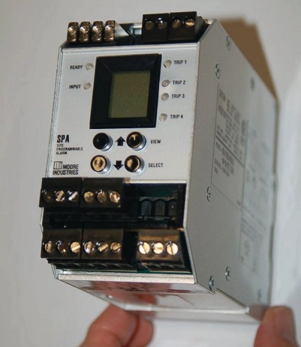

An example of an electronic temperature switch module is the Moore Industries model SPA (“Site Programmable Alarm”), shown here:
Not only is this particular model capable of directly interpreting both RTD and thermocouple signals, but it will also input 4-20 mA loop current signals as well. This means you may build a temperature switch system out of a 4-20 mA loop-powered temperature transmitter (located in the field) and an SPA switch module (located in a protected environment such as a control room or electrical enclosure). Many other manufacturers and models of electronic switching units exist, with the Moore Industries SPA being just one example.
