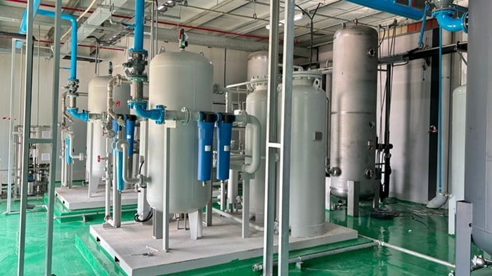

 Figure 1. A standard industrial compressor application.
Figure 1. A standard industrial compressor application. Image used courtesy of Adobe Stock

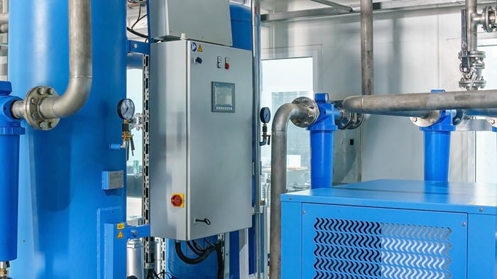

 Figure 2. Control panel of an industrial compressor system.
Figure 2. Control panel of an industrial compressor system. Image used courtesy of Adobe Stock

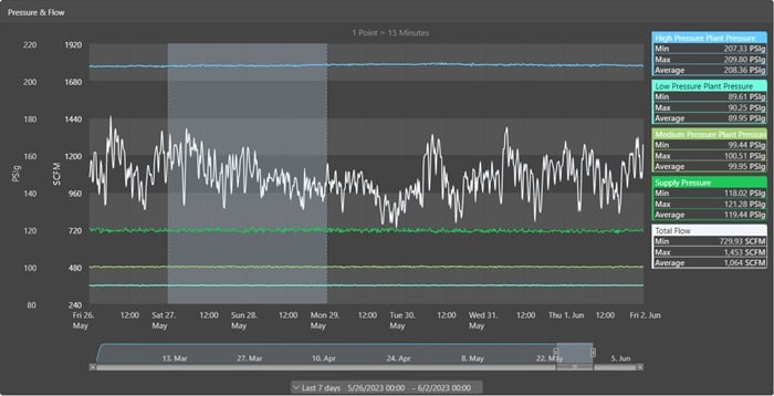

One of the more useful performance metrics is compressor-specific power, typically expressed as kilowatts per 100 cubic feet per minute (kW/100 CFM). This measurement helps engineers evaluate how efficiently compressed air is being produced relative to actual output. A system can maintain stable pressure while operating inefficiently, which is why energy consumption and airflow should always be evaluated together.
 Figure 3. Optimizing a compressed air system with data.
Figure 3. Optimizing a compressed air system with data. Image used courtesy of CAM Technologies
