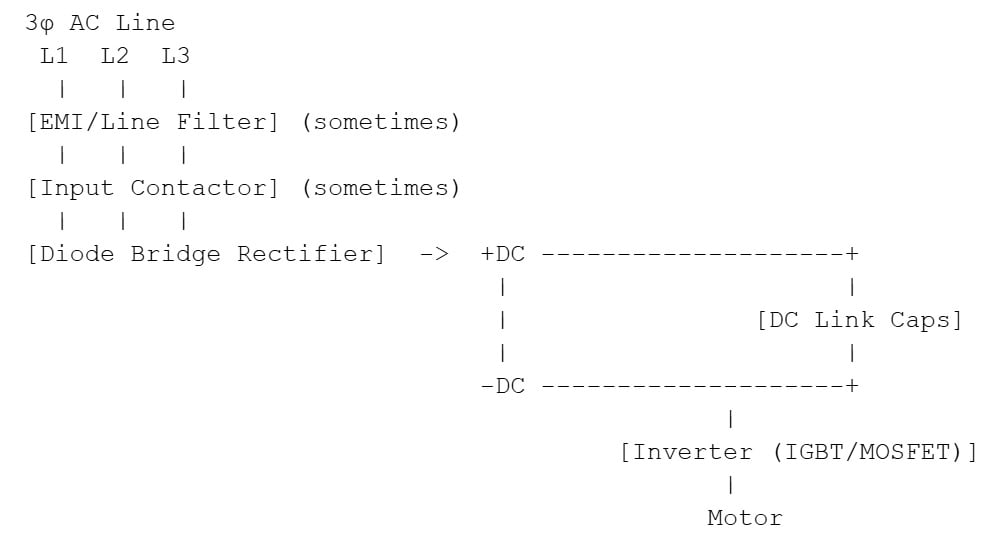

Figure 1. The drive front end at a glance. Image used courtesy of Wake Industrial
The rectifier converts incoming AC into DC. The DC link capacitors smooth that DC into a stable supply for the inverter, which synthesizes the variable-frequency/variable-voltage output to the motor. On many 480 VAC three-phase drives, a healthy, charged DC bus is commonly in the ~650–680 VDC range (exact values vary by topology and line conditions).
Why Does Inrush Current Happen?
At turn-on, the DC link capacitors are in their discharged state. Electrically, a discharged capacitor initially behaves like a short. The rectifier will try to charge the capacitor bank immediately, limited only by the system impedance (transformer, feeder, line filter, wiring, etc.). The resulting surge, or inrush current, can be large enough to open input fuses, trip upstream breakers, cause pitting on switching contacts, and stress the rectifier and bus components.

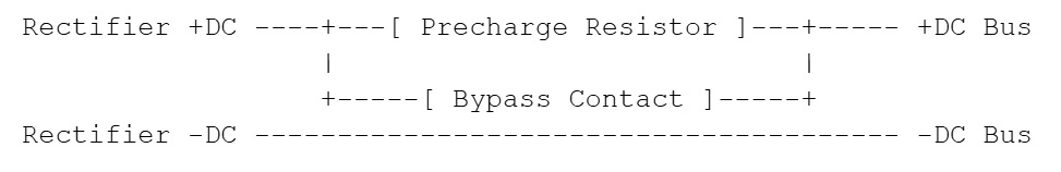

Figure 2. Precharge circuits: purpose and sequence. Image used courtesy of Wake Industrial
In normal startup operation, the bus voltage rises smoothly over a fraction of a second to a few seconds, limited by a precharge resistor. When the drive reaches a preset voltage threshold within a certain time, a bypass contactor/relay closes. Many drives make an audible click when this contact closes. If the drive never transitions to bypass, the bus may stall at a partial voltage or rise too slowly and trigger a timeout.
For practical context on capacitor behavior after extended storage (and why reforming is sometimes recommended), see ABB’s capacitor reforming instructions.
DC Bus Component Failures
Rectifier (diode bridge): A shorted diode or bridge assembly often produces immediate fuse opening at energization. An open or weak diode can allow the control section to power on while the bus never reaches the expected level, and it may increase ripple and heating.
DC link capacitors: Catastrophic capacitor failures can present as a hard short (instant fuse/breaker trip). Gradual degradation typically increases ESR and reduces effective capacitance, which can show up as nuisance undervoltage, unstable bus under load, or a charge timeout where the bus never reaches the threshold quickly enough during precharge.
Precharge resistor/bypass relay or contactor: An open precharge resistor, a bypass device that fails to pull in, or a sensing fault that prevents the bypass command are frequent causes of stuck charging, won’t enable, or repeated startup faults.

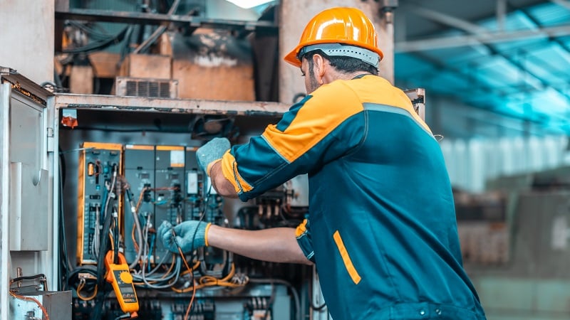

Figure 3. VFD failures should be identified rather than simply guessed. Image used courtesy of Adobe Stock
Interpreting Startup Symptoms Without Guessing
Learning to recognize failure symptoms can greatly accelerate the troubleshooting process.
Instant Fuse/Breaker Trip at Power-on
An immediate trip at energization strongly suggests a hard short in the front end. The most common offenders are shorted DC link capacitors or a shorted rectifier. Shorted surge suppression components (MOVs) can also cause instantaneous fuse opening. While an inverter short can sometimes reflect back as an input event, instant input fuse blow typically points to the rectifier/DC link first.
