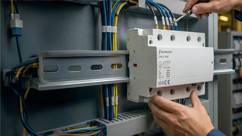

 Figure 1. NC contactor assembly mounted on a DIN rail inside a motor‑control panel, used as part of an isolation or fail‑safe stage.
Figure 1. NC contactor assembly mounted on a DIN rail inside a motor‑control panel, used as part of an isolation or fail‑safe stage. Image used courtesy of Contactor Depot
This article is written for control and motor‑control engineers who specify contactors and write the logic around them. The goal is to use NC behavior—including NC auxiliaries, mirror‑contact concepts, and energize‑to‑trip arrangements—to move loads toward a defined safe state under credible faults, and to make welded contacts and feedback mismatches visible instead of mysterious.

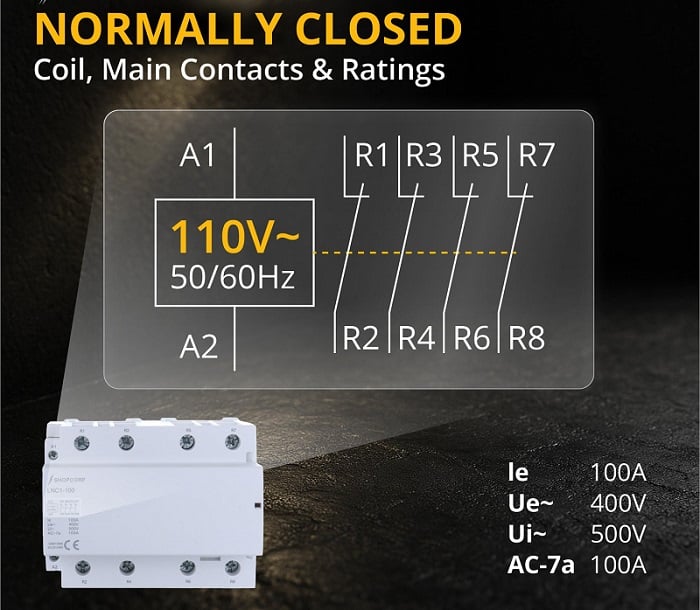

 Figure 2. Simplified diagram of an NC contactor showing the coil terminals and four normally closed main poles (R1–R2, R3–R4, R5–R6, R7–R8) used for isolation or fail‑safe behavior.
Figure 2. Simplified diagram of an NC contactor showing the coil terminals and four normally closed main poles (R1–R2, R3–R4, R5–R6, R7–R8) used for isolation or fail‑safe behavior. Image used courtesy of Contactor Depot
For practical design work, it helps to keep three ideas separate:
  1. Normal state: device at rest with coil de‑energized (NO contacts open, NC contacts closed).
  2. Safe state: condition of the load that reduces risk for people, equipment, and environment in a given hazard analysis.
  3. Fail‑safe behavior: overall circuit response in which loss of control power, open circuits, or certain internal faults cause the system to tend toward that safe state rather than away from it.
Once these are defined explicitly, the question of NO vs. NC becomes part of the safety reasoning, not just a drafting habit.
