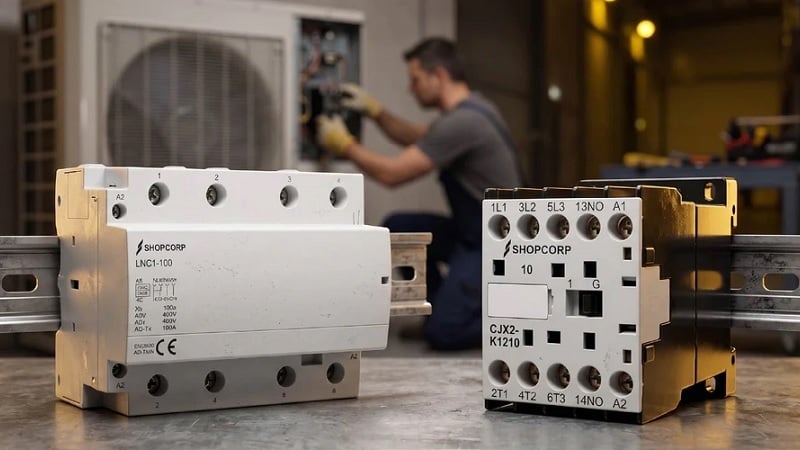

 Figure 1. Form factors of standard motor contactors.
Figure 1. Form factors of standard motor contactors. Image used courtesy of Contactor Depot

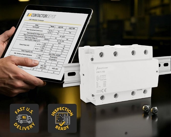

 Figure 2. Example of a four‑pole NC contactor with its specification sheet, including current ratings, utilization categories, and applicable IEC/CE standards.
Figure 2. Example of a four‑pole NC contactor with its specification sheet, including current ratings, utilization categories, and applicable IEC/CE standards. Image used courtesy of Contactor Depot
If you are evaluating concrete hardware options, a product example of a multi‑pole, normally closed IEC contactor assembly illustrates how NC poles are packaged and rated for mixed motor and lighting loads, including HVAC‑type applications, when used as part of a de‑energize‑to‑trip isolation stage rather than as a conventional motor starter.
