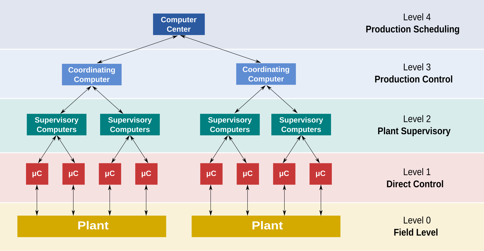

Historically, PLCs were designed to control individual machines or operations. As systems became more integrated, the need emerged to manage entire facilities, rather than just specific machines. Therefore, DCS became the architecture that integrated all of these pieces into one system while still maintaining some local control of machines.
DCSs were typically designed by a single vendor for deployment across the facility. While integration and compatibility were nearly guaranteed, the system was not easily customizable after initial installation, and third-party support was non-existent. Ultimately, companies were locked into a particular vendor, reducing interoperability.

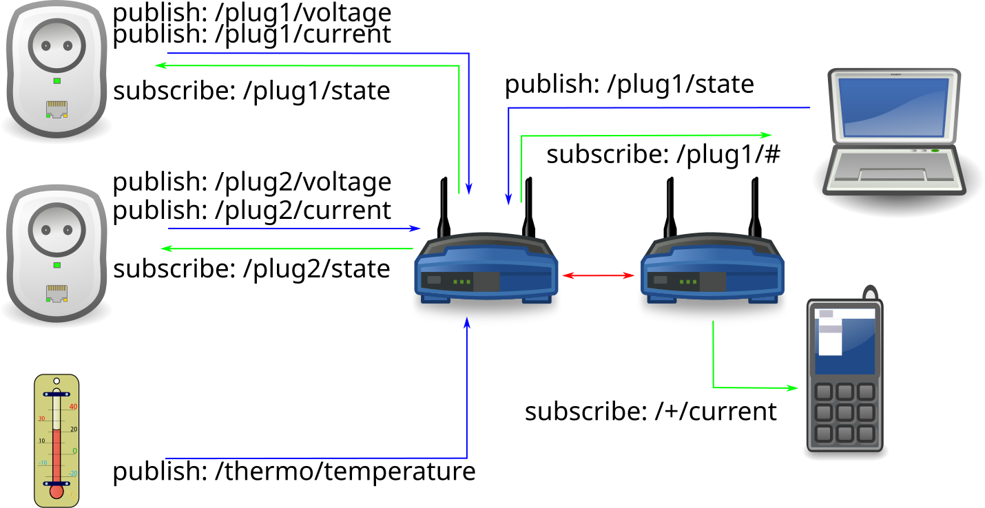

With these criteria in mind, Andy Standford Clark (IBM) and Arlen Nipper (Arcom/Eurotech) developed MQTT in 1999. MQTT is a publish/subscribe protocol for data transfer. In this model, sensors publish data that can be accessed by multiple subscribers.
Figure 2: MQTT architecture example. Image courtesy of Wikipedia Commons.
Figure 2. MQTT architecture example. Image used courtesy of Wikipedia Commons
By its very nature, MQTT is an open architecture. As it evolved, data could be published to the cloud and subscribed to by smartphones and tablets. Ultimately, MQTT was an important stepping stone to today’s Industrial Internet of Things (IIoT).

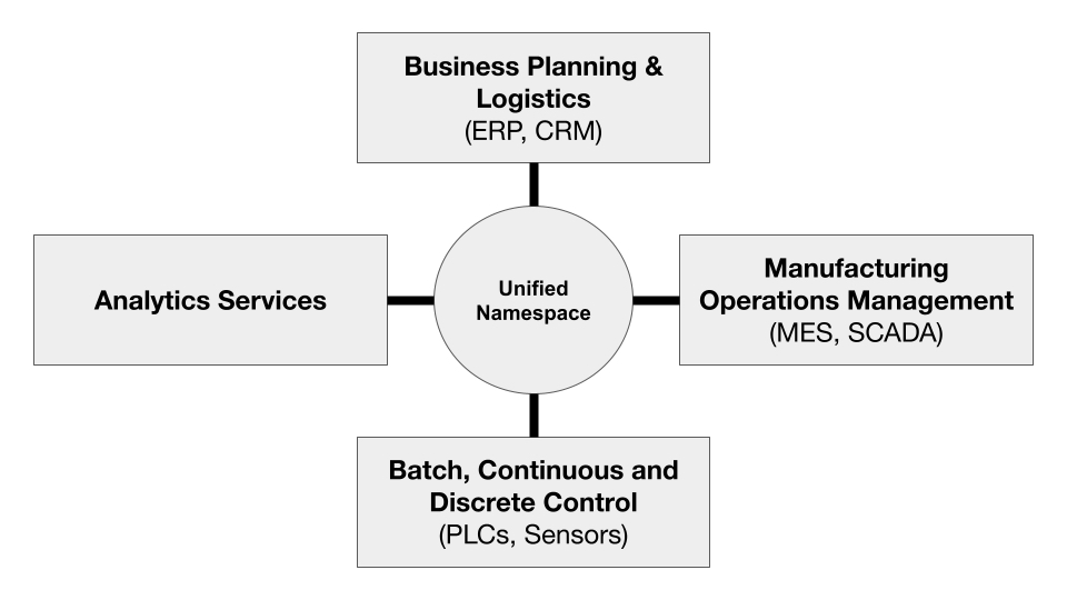

Automation morphed from a few, limited sensors and tiny data sets to the “big data” era, where sensors are inexpensive and plentiful. Data has to be treated differently than in previous times. Unified Namespace (UNS) is an architecture that acts as a real-time “Single Source of Truth”, meaning that all devices can publish or subscribe to data from this source. All data is standardized and communicated through a centralized namespace, making it platform- and vendor-independent.
Figure 3: UNS allows for custom architecture that interfaces with all plant hardware. Image source:  Wikipedia Commons.
Figure 3. UNS allows for custom architecture that interfaces with all plant hardware. Image used courtesy of Wikipedia Commons
UNS is also based on a publish/subscribe model. In this, PLCs, edge-of-network devices, manufacturing execution systems (MES), and all other hardware can interface with the UNS. Instead of connecting these devices to SCADA, SCADA is a consumer of data deposited in the UNS. This drastically reduces the complexity and cost of deployment and data management.
