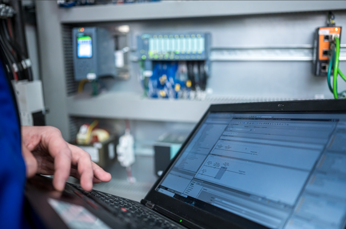

A programmer troubleshooting a PLC in an industrial facility.
A programmer troubleshooting a PLC in an industrial facility. Image used courtesy of Shutterstock

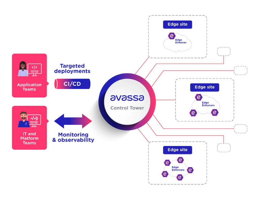

OnLogic is overcoming the limitations of PLCs with industrial computing hardware engineered for distributed edge applications. Their systems provide the raw processing power and connectivity needed to run multiple containerized applications while maintaining the environmental resilience needed in manufacturing environments. The platforms support both legacy industrial protocols as well as modern networking standards, simplifying integration challenges. Avassa complements this hardware foundation with edge orchestration software that brings cloud-native application management to industrial environments. It enables centralized deployment and management of distributed applications and maintains the local autonomy that industrial operations need. The combination of these technologies allows engineering teams to manage hundreds of distributed control applications from one central location.
Avassa provides automated and efficient placement and versioning functionality of containers and the ability to monitor and observe application health.
Avassa provides automated and efficient placement and versioning functionality of containers and the ability to monitor and observe application health. Image used courtesy of Avassa
Ultimately, OnLogic+Avassa is a transition from hardware-centric to software-centric industrial control. This approach enables manufacturers to implement control logic changes across entire operations in minutes rather than weeks, integrate more effectively with analytics and AI systems, and scale without a proportional increase in management complexity.
