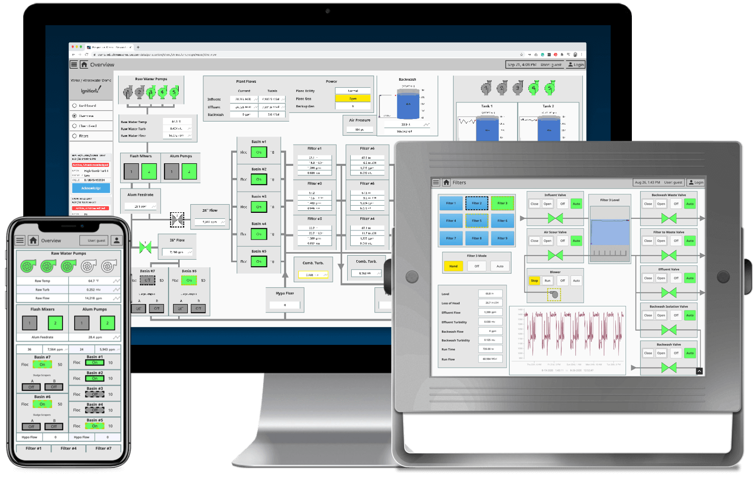

Figure 1. Data is dashboards, but it is also planning out which datasets are sent to which locations, who has access, what to collect and how to store it.
Figure 1. Data is dashboards, but it is also planning out which datasets are sent to which locations, who has access, what to collect, and how to store it. Image used courtesy of Inductive Automation
