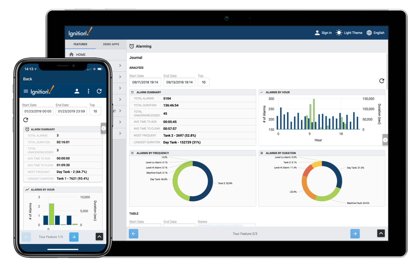

Figure 2. Through Ignition!, HMIs and dashboards, even from legacy devices, can be made portable.
Figure 2. Through Ignition!, HMIs and dashboards, even from legacy devices, can be made portable. Image used courtesy of Inductive Automation
One possible method, though it has some risks, is collecting data from SCADA and using OPC-UA to work with the data independent of the platform. It can be effective, provided the extra load on the SCADA system is not already running at capacity. It may also require the setup and configuration of an additional SCADA server, which is not necessarily a barrier, but another consideration.
