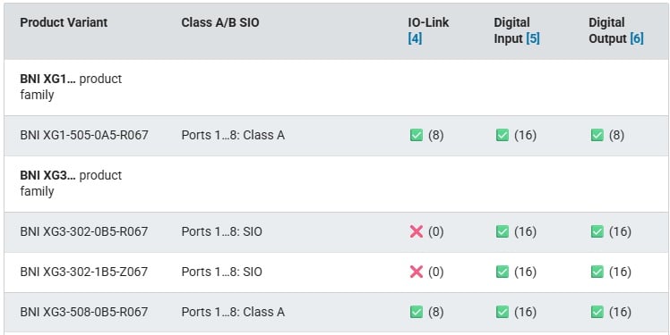

Number: Some IO-Link masters allow an open configuration of all the IO-Link ports. Others may only allow half of the ports to be configured. The quick way to verify (if it’s not spelled out right on the datasheet) is to check the number of “standard” I/O ports. If the data lists 8x IO-Link ports and 8x standard I/O, then we can safely assume that only four of the ports can be switched, each providing two I/O signals.
Polarity: When I/O enters the conversation, obviously, the technician needs to consider the NPN/PNP question. Check the datasheet to be sure that you’re purchasing the right part. However, beyond the NPN/PNP question, there is the matter of input vs. output. Each of those ports can handle two I/O signals, and while you might find that they can both be inputs, only one may be capable of driving an output device.
The way to verify is, once again, handed to us on the IO-Link master datasheet: if it lists 16x PNP inputs, but only 8x PNP outputs, then we know that all 8 of the ports can be switched to standard I/O, but only one pin can be used as an output.
 Figure 2. Examine this excerpt from the datasheet: the XG1 product has 8 total ports. They can all be IO-Link ports. They can all be switched to standard I/O, and each can function as two inputs (16 total), but only one output (8 total). Note the differences in the XG3 family.
Figure 2. Examine this excerpt from the datasheet: the Balluff XG1 product has 8 total ports. They can all be IO-Link ports. They can all be switched to standard I/O, and each can function as two inputs (16 total), but only one output (8 total). Note the differences in the XG3 family.

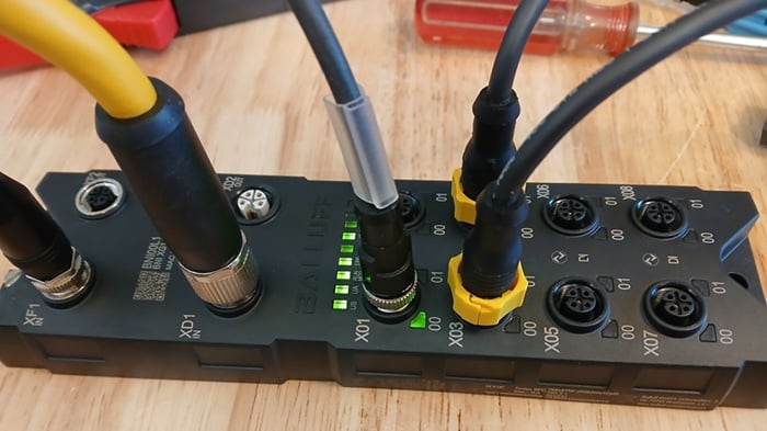

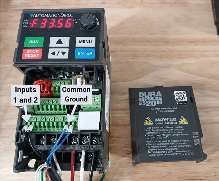

First, connect an M12 cable from a spare port on the IO-Link master. Connect the blue M12 wire to the common ground of the VFD terminals and the black wire to the VFD digital input 1.
 Figure 3. This IO-Link project is using ports X03 and X04 (the M12 cables with the yellow collars).

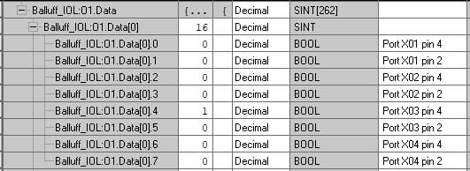

On the IO-Link master, the tag list contains a configuration block of data. The first byte or two of the configuration data sets the port type (this is fairly universal, but check your model before assuming I’m always correct here). There are usually two bits that must be set per port, one for each pin. That means that [byte 0] : [bits 0 and 1] set the function of pins 4 and 2 of the first port. Then, [bits 2 and 3] set the functions for the next port, and so on. If these bits all hold 0, it’s a standard I/O port. But if they hold a 1, the port is activated for IO-Link.
Change those bit values to 0 for your port.
Now, you can open the output data tags and write 1 into the appropriate bit. In most IO-Link setups, [byte 0] : [bits 0 and 1] write the output status of pins 4 and 2 of the first port. The black wire is pin 4, therefore, we write to bit 0, and the VFD should start.
Note: My setup uses port 3, not port 1. So I use bit 4 instead of bit 0 in the tag list below.
 Figure 4. Bits used to drive the standard digital output terminals.

If your particular IO-Link master supports two outputs per port, then simply connect the white wire (pin 2) of the M12 cable to the VFD's digital input 2 terminal. This is driven from [byte 0] : [bit 1].
 Figure 5. The M12 cables connected to the VFD inputs.
On the other hand, if the IO-Link master only supports one output per port, then you need a second M12 cable connected to the next IO-Link master port. Connect the blue wire to the common ground of the VFD, just like the previous one, and the black wire (pin 4) to the VFD's digital input 2 terminal. This is driven by [byte 0] : [bit 4].
