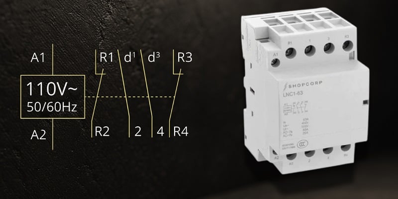

 Figure 1. DIN‑rail 4‑pole (2NO/2NC) contactor device and schematic.
Figure 1. DIN‑rail 4‑pole (2NO/2NC) contactor device and schematic. Image used courtesy of Contactor Depot

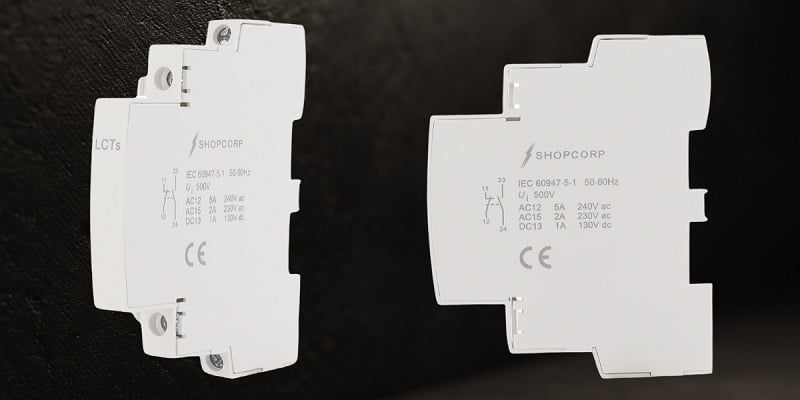

 Figure 2. Two clip‑on auxiliary contact blocks with NO/NC terminal markings, providing additional feedback signal points.
Figure 2. Two clip‑on auxiliary contact blocks with NO/NC terminal markings, providing additional feedback signal points. Image used courtesy of Contactor Depot

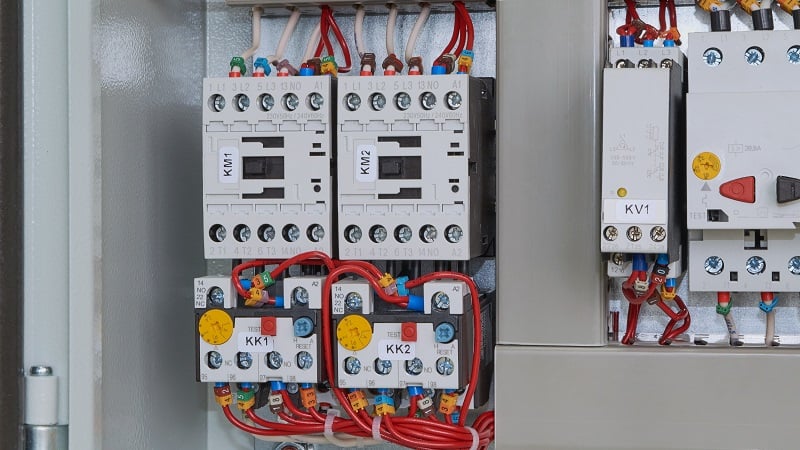

 Figure 3. Some contactors include aux contacts, while others require add-on blocks.
Figure 3. Some contactors include aux contacts, while others require add-on blocks. Image used courtesy of Adobe Stock
