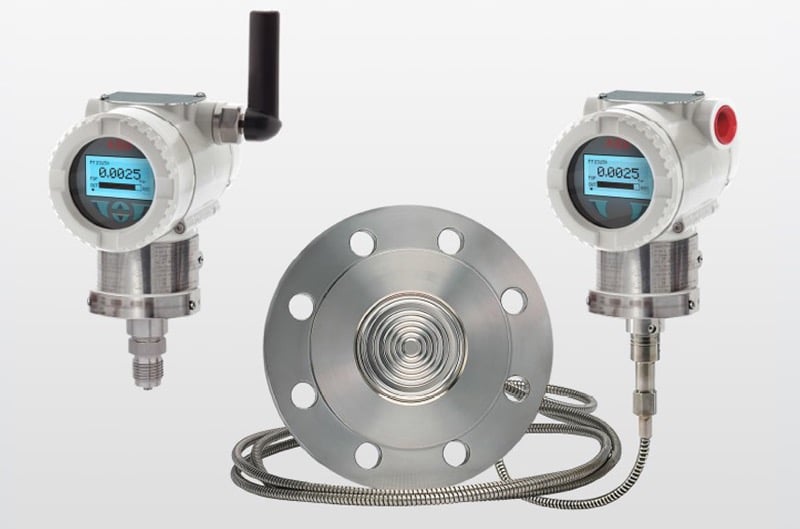

The P-300 holds steady at 0.055% accuracy, whether handling tiny pressure differences or pushing into the high-pressure range.
The P-300 holds steady at 0.055% accuracy, whether handling tiny pressure differences or pushing into the high-pressure range. Image used courtesy of ABB
ABB’s new P-300 pressure transmitter series, now available in the United States, is meant to close those gaps. Designed to deliver 0.055% accuracy across a wide pressure range, from as low as 0.05 kPa up to 105 MPa, the P-300 series offers a single platform for applications ranging from fine differential measurements to high-pressure monitoring.
Designed for Operator Confidence
ABB put usability front and center with the P-300. The units have a high-contrast HMI with a backlit display that stays readable in bright sunlight or dim plant corners. A touch keypad interface enables quick on-site adjustments without extra tools, and Bluetooth support allows safe configuration from a distance. QR-code-enabled Digital Advanced Diagnostics (DAD) connects plant technicians directly to manuals and product information while troubleshooting their systems.
P-300 transmitters with rugged diaphragm seals for any environment, indoors or out.
P-300 transmitters with rugged diaphragm seals for any environment, indoors or out. Image used courtesy of ABB
In industries where process fluids can be corrosive, abrasive, or extreme in temperature, transmitters must withstand more than just pressure swings. The P-300 line can be paired with ABB’s S26 diaphragm seal series, which uses a welded design and Diaflex anti-abrasion diaphragm. This protects against harsh slurry conditions common in various everyday industries, ranging from mining, chemical, and pulp and paper applications, reducing wear and extending service life. The S26 also offers flexibility in mounting, either directly or through capillaries, and comes in sanitary versions for food, dairy, and pharmaceutical environments. By isolating the transmitter from difficult process fluids, operators can maintain accuracy while avoiding damage to the sensor itself.

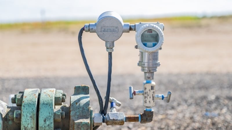

The image above depicts the PGS300/PAS300 models available in the P-300 lineup.
PGS300/PAS300 models are available in the P-300 lineup. Image used courtesy of ABB
