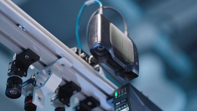

OmniCore EyeMotion is hardware-agnostic, meaning it can be paired with any sensor or camera mounted on an OmniCore-powered robot
OmniCore EyeMotion is hardware-agnostic, meaning it can be paired with any sensor or camera mounted on an OmniCore-powered robot. Image used courtesy of ABB Robotics
OmniCore EyeMotion
Simply adding cameras to a robot will not help the robot to “see.” The heart of a machine vision system is in software, and that is where ABB’s new OmniCore EyeMotion excels. It includes an intuitive user interface featuring drag and drop options for sensors and cameras and an extensive framework for performing 2D and 3D machine vision applications. Camera options include many third-party cameras, meaning that as camera technology improves, replacing a camera enhances production, rather than requiring extensive downtime for reprogramming and redesign.
