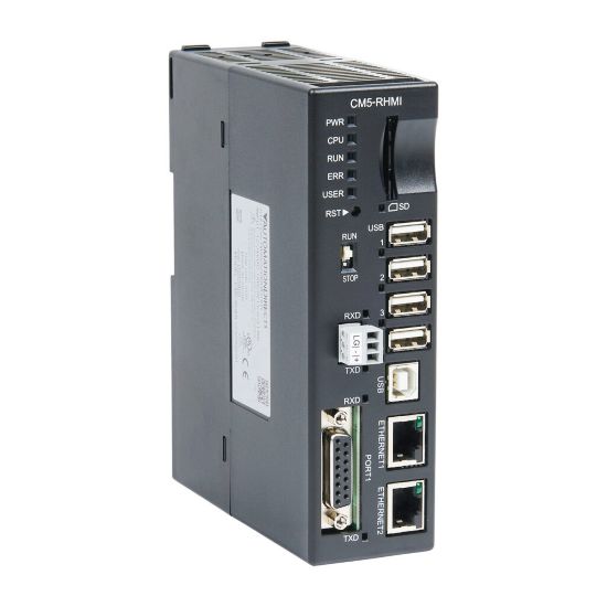

The new C-more CTM industrial monitors are compatible with AutomationDirect’s C-more CM5-RHMI headless HMIs (pictured above)
The new C-more CTM industrial monitors are compatible with AutomationDirect’s C-more CM5-RHMI headless HMIs (pictured above). Image used courtesy of AutomationDirect
