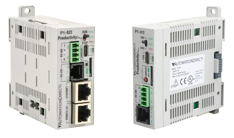

New Productivity1000 CPUs
Two new CPUs have been added to support the most advanced and simplest applications. The P1-622 is an enhanced version of the P1-550 CPU that includes a newer USB-C programming connector and uses a latching micro SD card holder with an unmount button on the front to ensure a safer removal process when the CPU is powered on. The P1-622 also benefits from a slightly lower cost than the P1-550, while still boasting the same memory and communication specs.
The two new CPU models for the Productivity1000 PLC series.
The P1-412 is a budget-friendly CPU designed for simpler applications. It includes 32 MB of memory capacity, slightly lower than the 50 MB of the P1-540, the smallest CPU in the series until now. Like the other new CPU, it includes a USB-C programming port and a button to unmount the micro SD card. The single Ethernet port is located on the bottom of the CPU, reducing the footprint to provide the thinnest CPU module in the series.

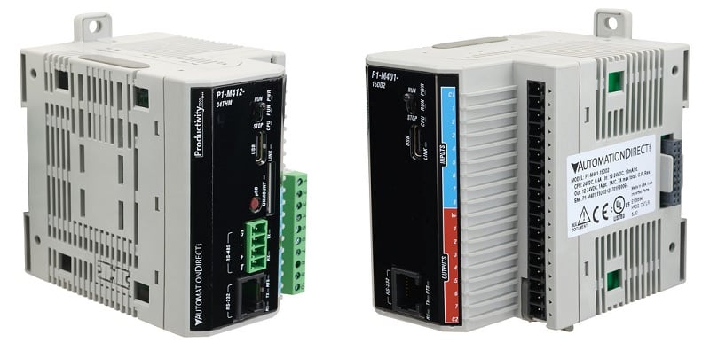

Mini PLCs With Embedded I/O
Many applications do not require modular I/O. If the I/O is embedded onto the CPU, the step of hardware configuration can be omitted entirely. The only downside to integrated I/O is that the number and type of terminals must fit the project. Therefore, a wide range of model options is available for these mini PLCs. The I/O options include the following types:
  • Discrete input
  • Discrete input/output combo
  • Analog input (current only)
  • Thermocouple input
  • Analog input/output combo (current only)
The Mini PLCs have many discrete and analog I/O options.
All models in the series include USB-C and RS-232 serial connections, and many models also include Ethernet support. These PLCs can also be expanded with the I/O module catalog already supported by the Productivity1000 series.
