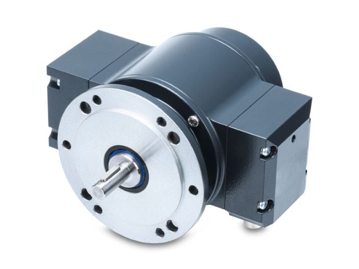

Baumer’s company Hüber Berlin, known mostly for encoders and tachogenerators, has developed a new, simple-to-use digital cam switch. The PMG93 CAM features a rugged design for heavy-duty applications and boasts a simple setup and configuration to bring hoist and winch systems online quickly.
Baumer Hüber Berlin’s HeavyDuty PMG93 digital cam switch is designed to simplify heavy-duty hoist and winch applications

The PMG93 CAM is a digital cam switch branded under Baumer’s “HeavyDuty” portfolio, highlighting its suitability in harsh, outdoor industrial environments. According to Baumer, the switch has no mechanical parts, making it nearly immune to external wear from vibration and impact.
One of the key features of the HeavyDuty PMG93 is its quick and easy configuration. Changes to the system can be made quickly, with little downtime. Instead of using proprietary software and relying on technicians with specialized training, the PMG93 can be programmed with a web browser interface and an Ethernet connection. It is truly software independent, as there is no software, just a browser interface. Furthermore, no internet access is required, just an Ethernet cable and a laptop.
Each switch can be programmed using a “teach” mode, meaning technicians with little training can bring the cam switch online and perform properly. The digital parameterization and a wide assortment of mounting kits means that only one PMG93 is required for most applications. There is no need to buy multiple cam switches for different-sized hoists; one can be configured quickly for each. It can be used in new installations and retrofit and modernize existing hardware.
