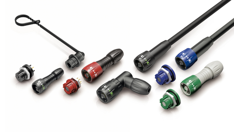

Binder has launched a new circular connector solution that protects electrical interfaces even when not connected. The Not Connected Closed (NCC) connector family solves a common problem in industrial systems: exposed contacts when connectors are unplugged. It uses a spring-loaded sealing mechanism in the female panel connector that automatically closes a cover over the contacts, keeping out dust, dirt, and moisture.
The NCC circular connector family is available in subminiature and miniature variants
The NCC circular connector family is available in subminiature and miniature variants. Image used courtesy of Binder

Binder’s new Not Connected Closed (NCC) connectors feature a design that solves the problem of exposed contacts by keeping the connector sealed even when unplugged. In NCC connectors, the female panel mount has a spring-loaded cover that closes over the contacts when unplugged. When a plug is inserted, it pushes the cover open to make electrical contact. This removes the need for separate protective caps and keeps the interface protected between uses.
Key Features of the NCC Connector Family
The NCC connectors come in the 670 and 770 series, both with compact circular designs that save space and offer built-in protection. The 670 series is a subminiature format with five contact pins, while the 770 series offers miniature connectors with eight contact pins. Both types support signal and low-power applications.
The two series use DEHP-free plastic housing for safety and environmental compliance. The female panel mount has a spring-loaded plastic cover that automatically shields the connector from the environment.
Binder offers different protection levels depending on whether the connector is plugged in. The 670 series provides IP54 protection when plugged in, guarding against dust and water splashes, and upgrades to IP67 when mated for even better protection. The 770 series offers IP67 protection whether connected or not, making it a good choice for dusty or humid workshops and ensuring reliable connections even with frequent use.
