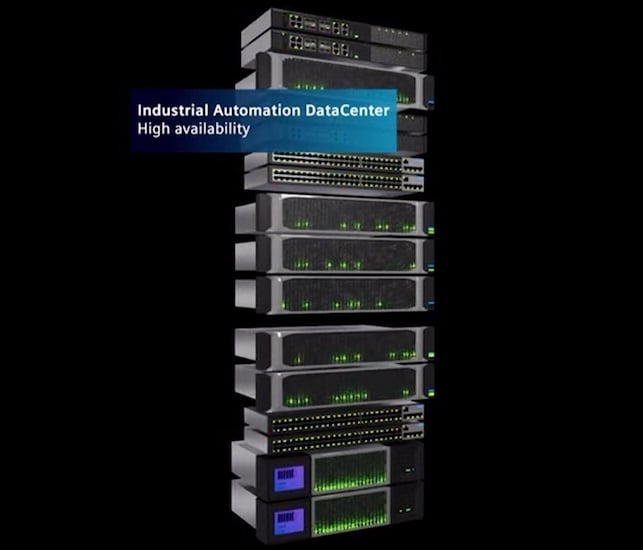

The IADC from Siemens is hoped to liberate OT software from physical assets and provide greater resilience through secure management. Image used courtesy of Siemens

Essentially, applications no longer need to be run on individual computers dotted around the factory but are converted into VMs within the IADC’s hyperconverged framework.
Essentially, applications no longer need to be run on individual computers dotted around the factory but are converted into VMs within the IADC’s hyperconverged framework. Image used courtesy of Siemens
This not only saves space but also allows software to be conserved literally outside of the box, so that if a physical asset fails for the given application (such as WinCC), the VM can be restarted on another physical node within the server rack. When the VM reboots, the operator may see a flickering screen or a short blip, but the system comes back online, and the operator does not have to spend valuable time fiddling with cables or reconstructing a costly PC. This is where the IADC serves as a connective bridge between IT/OT, secure management, and accessibility, providing a safety net for OT software in the event of potential IT hardware failures.
