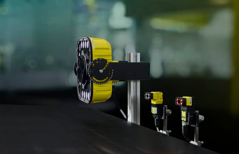

Cognex has launched the SLX logistics portfolio with three new devices: the SLX-280D, SLX-290, and SLX-3816
Cognex has launched the SLX logistics portfolio with three new devices: the SLX-280D, SLX-290, and SLX-3816. Image used courtesy of Cognex

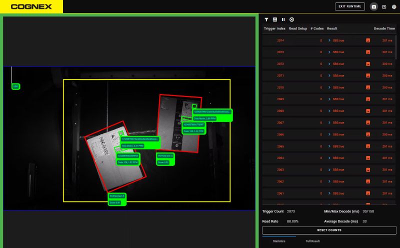

Similar to the SLX-280D, the SLX-290 is a barcode reader and object detection vision system. By using a web-based interface, users can teach the SLX-290 what a box is versus a poly bag, and the internal AI vision tools will report the different objects while the system is in production. At the same time, the barcode can be decoded for object tracking purposes.
The reader is designed with simplicity in mind. According to Cognex, no technical knowledge is required to set up the reader. Simply connect to a computer via the Ethernet cable and open the web interface; there is no software or firmware that needs to be downloaded. The results can be used to drive the two opto-isolated outputs or sent back to a control system using either Ethernet/IP or Profinet.
