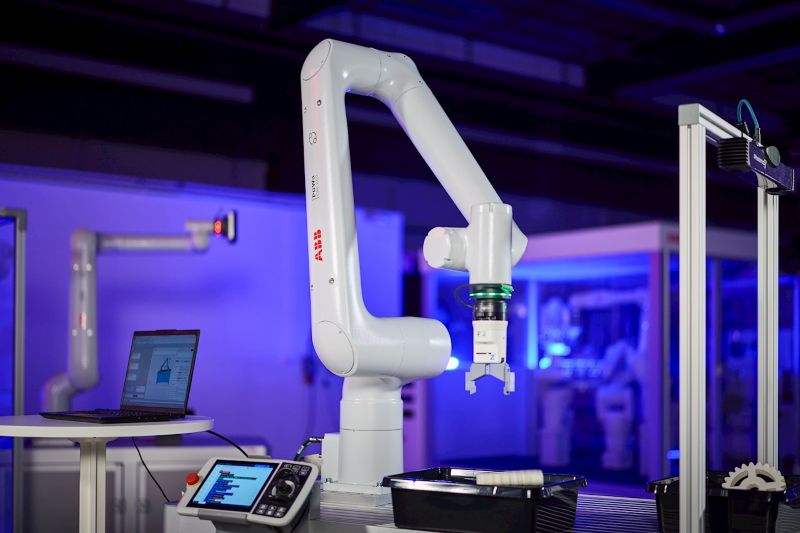

The PoWa robots feature 7 kg to 30 kg payloads and speeds of up to 5.8 m/s. Image used courtesy of ABB Robotics

Users can program the PoWa robots with ABB Robotics’ suite of AI-powered software tools. Video used courtesy of ABB Robotics
AI-Powered Software Tools
At the heart of each PoWa robot is an ABB OmniCore controller platform that easily integrates with the robot family. Users can program the robots using ABB Robotics’ suite of software tools, including ABB’s Wizard Easy Programming and Robot Studio, which eliminate the need for extensive programming knowledge.
Each of these tools has built-in AI capabilities, helping programmers optimize motions safely and efficiently. Additionally, Robot Studio features an augmented reality viewer that lets operators visualize the robot’s path on mobile devices. The Wizard Easy Programming module is particularly intuitive, enabling operators to teach robots in as little as ten minutes.

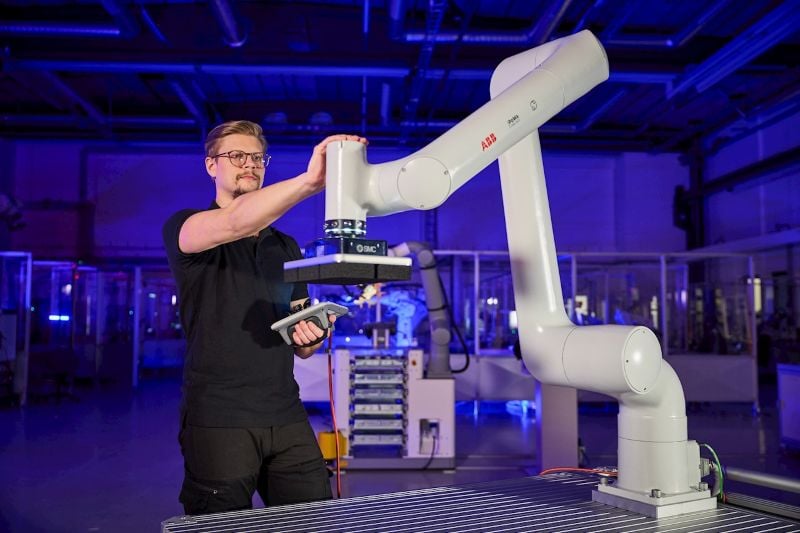

A technician trains a PoWa robot
A technician trains a PoWa robot. Image used courtesy of ABB Robotics
