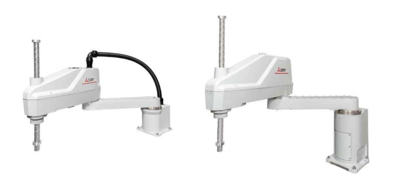

Comparison of the RH-12FRH to the new RH-10CRH (left) and the RH-20FRH to the new RH-20CRH
Comparison of the RH-12FRH to the new RH-10CRH (left) and the RH-20FRH to the new RH-20CRH. Image used courtesy of Mitsubishi Electric

Mitsubishi Electric’s RH-10CRH8030-D (left) and the RH-20CRH10042-D SCARA robots
Mitsubishi Electric’s RH-10CRH8030-D (left) and the RH-20CRH10042-D SCARA robots. Image used courtesy of Mitsubishi Electric
