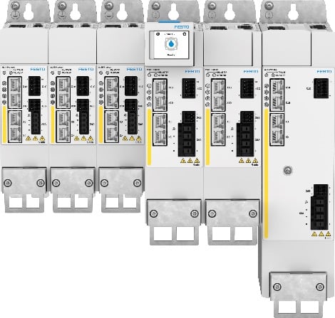

Festo’s new line of servo drivers, the CMMT-AS, offers simplified wiring and enhanced safety by including some of the necessary hardware and connections internal to the driver. External safety mechanisms can either be hardwired to the digital I/O ports or over a PROFIsafe network for easy integration with Siemens safety PLCs.
There are two styles available: Basic (S1) and Advanced (S3). Both styles have built-in Safe Torque Off (STO), Safe Brake Control (SBC), Safe Stop 1 (SS1), as well as onboard diagnostics. SS1 is a way to perform a controlled stop before removing power, which requires an external timer. The S3 models feature the external timer, as well as another Safe Stop 2 (SS2) option, Safe Operating Stop (SOS), and speed control limiters.
A collection of CMMT-AS drives, ranging in size from 350 W to 12 kW.
A collection of CMMT-AS drives, ranging in size from 350 W to 12 kW. Image used courtesy of Festo
Both lines of drives can be configured in Festo’s Safety Configurator, which is part of the Festo Automation Suite. They will also be compatible with the upcoming Validation Wizard (expected Winter 2025) that will automate documentation and guide engineers through the configuration process.
