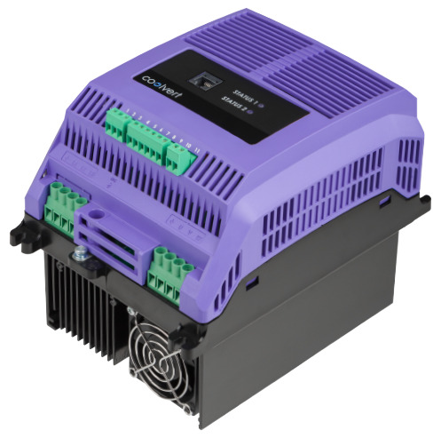

Invertek Drives, a global manufacturer of variable frequency drives (VFDs) for a variety of industries, has upgraded its Optidrive Coolvert series of high-performance drives specifically designed and manufactured for brushless DC (BLDC) compressors, heat pumps, and cooling distribution units (CDUs). The Coolvert lineup previously only had Frame Sizes 2, 3, and 4. It will now include a size 5 for customers. The entire line has also been updated to meet the latest industry standards in safety.
Invertek Drives has expanded its line of Optidrive Coolvert high performance drives.
Invertek Drives has expanded its line of Optidrive Coolvert high-performance drives. Image used courtesy of Invertek Drives
Optidrive Coolvert High-Performance Drives
In the HVAC-R industry, safety and compliance require equipment manufacturers to undergo stringent testing. Invertek's OptiDrive Coolvert high-performance drives have obtained full approval for use with A2L and A3 refrigerants, the most up-to-date safety standards. The Coolvert series is also tailored to meet the cooling industry's requirements for BLDC compressors, heat pumps, and CDUs.
The Coolvert series offers sensorless vector control for various motor types including IE2, IE3, IE4, and IE5 induction, AC permanent magnet, BLDC, synchronous reluctance, and line start PM motors. The drive has an installation time of under 15 minutes. Additionally, the Coolvert drives are designed to be compact and feature through panel mounting, minimizing panel space. This allows for using a smaller cabinet while effectively dissipating heat with chilled air. As a result, the Optidrive Coolver maintains an IP20-rated front enclosure and offers an IP55-rated rear cold plate option.
The Coolvert Drives are designed for through panel mounting for compactness and thermal management.
The Coolvert drives are designed for through panel mounting for compactness and thermal management. Image used courtesy of Invertek Drives
